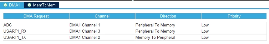

STM32F07 ADC MX_ADC_Init() Handler error
I'm using the cube for generating code for IAR

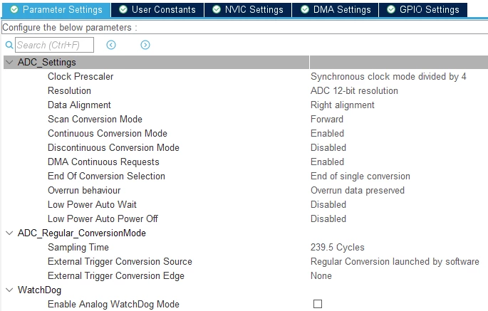

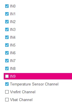

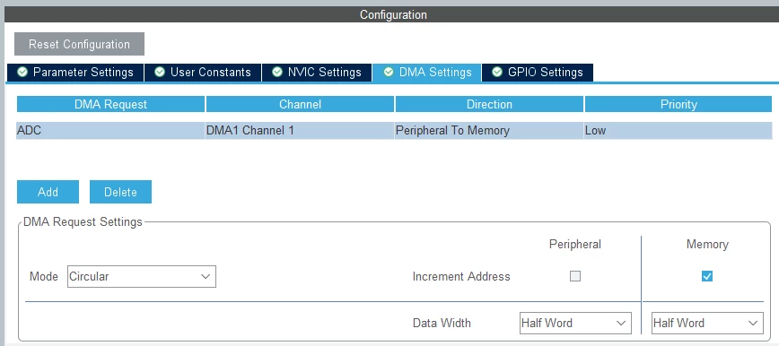

there is an ADC with to a DMA
the MX_ADC_Init() fail, can't tell why
 the ADC configuration:
the DMA configuration:
when i run the code, the fail point is:

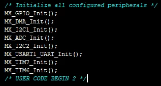

i have checked that the DMA is initiate first and then the ADC
any help will be appreciated
thank you
1 reply

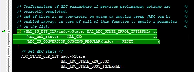

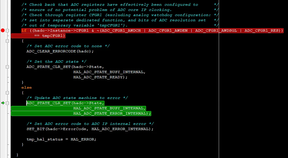

I have investigated the fail handle, the first time that the MX_ADC_Init() fail is after the assertion of the parameters:
at the stm32f0xx_hal_adc.c :
i can only guess that there is an issue implementing the parameters into the ADC
