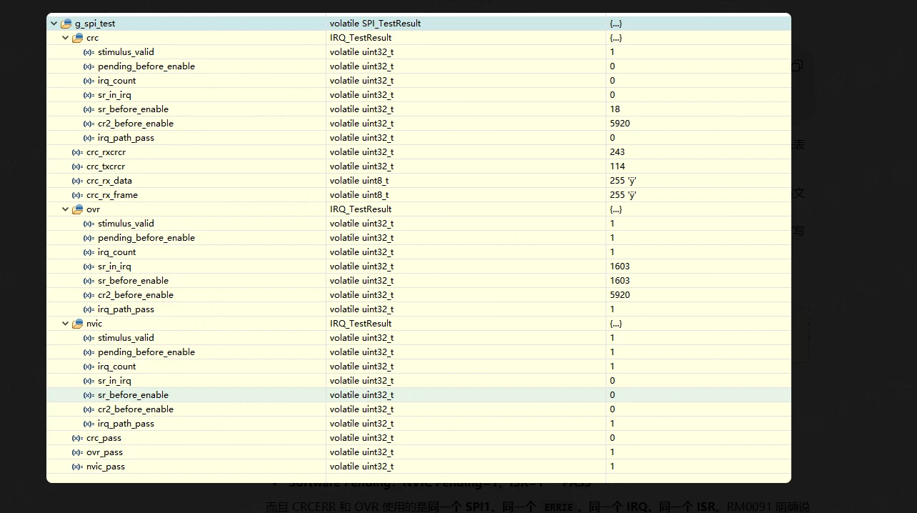

STM32F051C8 SPI CRCERR does not generate an error interrupt
I observed an issue on STM32F051C8 where the SPI CRCERR flag is correctly set after a CRC mismatch, but no SPI interrupt is generated even when SPI_CR2.ERRIE is enabled.
To reproduce the issue, SPI1 is configured as master mode, 8-bit data size, CRC enabled, CRC polynomial 0x07, using direct register access without HAL, LL, DMA, or an external SPI slave. PA6/MISO is configured with an internal pull-up, so the received data and CRC frame are both 0xFF.
In the CRCERR test, the SPI peripheral calculates RXCRCR = 0xF3, while the received CRC frame is 0xFF, so a CRC mismatch is intentionally generated. The final register values are:
SPI_SR = 0x0012, where CRCERR = 1
SPI_CR2 = 0x1720, where ERRIE = 1
RXCRCR = 0xF3
Received CRC frame = 0xFF
Therefore, the CRC mismatch is correctly detected by the SPI peripheral. However, before enabling the NVIC interrupt, NVIC_GetPendingIRQ(SPI1_IRQn) returns 0, and after enabling the interrupt, SPI1_IRQHandler is never entered.
The CRCERR test result is:
stimulus_valid = 1
pending_before_enable = 0
irq_count = 0
sr_before_enable = 0x0012
cr2_before_enable = 0x1720
crc_pass = 0
As a control test, I deliberately generate an SPI receive overrun (OVR) using the same SPI1 peripheral, the same ERRIE bit, the same SPI1_IRQn, and the same SPI1_IRQHandler.
The OVR test result is:
OVR = 1
ERRIE = 1
pending_before_enable = 1
irq_count = 1
ovr_pass = 1
This confirms that the SPI error interrupt path, ERRIE configuration, NVIC configuration, vector table, and interrupt handler are working correctly.
I also performed a third control test using NVIC_SetPendingIRQ(SPI1_IRQn). The NVIC pending bit is correctly set and SPI1_IRQHandler is entered:
irq_count = 1
nvic_pass = 1
The final comparison is therefore:
CRCERR = 1, ERRIE = 1 -> NVIC pending = 0, ISR not entered
OVR = 1, ERRIE = 1 -> NVIC pending = 1, ISR entered
NVIC software pending -> ISR entered
The attached debugger screenshot shows the complete g_spi_test structure after all three tests. The key result is crc_pass = 0, while ovr_pass = 1 and nvic_pass = 1.
Based on these results, CRC error detection itself is working correctly, and the general SPI1/NVIC interrupt path is also working correctly. The observed issue appears to be specific to the CRCERR to SPI interrupt request path.
Could you please confirm whether this is a known STM32F051C8 silicon limitation or erratum, or whether there is any additional condition required for CRCERR to generate an interrupt when ERRIE is enabled?

     * Enable SPI
    SPI1->CR1 |= SPI_CR1_SPE;
     * 故意不读 RX DR。
     * 连续发送多个 frame。
     * RX FIFO 填满后继续接收,
     * 应产生 OVR。
    for (i = 0; i < 16U; i++)
        while ((SPI1->SR & SPI_SR_TXE) == 0U)
        SPI1_DR8 = (uint8_t)(0x10U + i);
     * Wait all frames finish.
    while ((SPI1->SR & SPI_SR_BSY) != 0U)
     * Capture evidence BEFORE reading DR.
     * 很重要:
     * 不要提前读取 DR,
     * 否则可能影响 OVR 状态。
    g_spi_test.ovr.sr_before_enable =
        SPI1->SR;
    g_spi_test.ovr.cr2_before_enable =
        SPI1->CR2;
     * Confirm:
     * OVR   = 1
     * ERRIE = 1
    if (((SPI1->SR & SPI_SR_OVR) != 0U) &&
        ((SPI1->CR2 & SPI_CR2_ERRIE) != 0U))
        g_spi_test.ovr.stimulus_valid = 1;
    else
        g_spi_test.ovr.stimulus_valid = 0;
     * NVIC currently disabled.
     * OVR IRQ request should set Pending.
    g_spi_test.ovr.pending_before_enable =
        NVIC_GetPendingIRQ(SPI1_IRQn);
     * Enable NVIC.
    NVIC_EnableIRQ(SPI1_IRQn);
    WaitForIRQ(&g_spi_test.ovr.irq_count);
     * PASS condition
    if ((g_spi_test.ovr.stimulus_valid == 1U) &&
        (g_spi_test.ovr.pending_before_enable == 1U) &&
        (g_spi_test.ovr.irq_count > 0U))
        g_spi_test.ovr.irq_path_pass = 1;
    else
        g_spi_test.ovr.irq_path_pass = 0;
    g_spi_test.ovr_pass =
        g_spi_test.ovr.irq_path_pass;
     * Cleanup
    NVIC_DisableIRQ(SPI1_IRQn);
    NVIC_ClearPendingIRQ(SPI1_IRQn);
    g_active_test = TEST_NONE;
 * TEST C
 * Software Pending -> NVIC -> ISR
 * 验证:
 * - SPI1_IRQn 正确
 * - Vector table 正确
 * - SPI1_IRQHandler 名称正确
 * - NVIC enable 正常
 * - CPU interrupt response 正常
static void Test_NVIC(void)
    g_active_test = TEST_NVIC;
     * 让 SPI peripheral 保持 reset,
     * Test C 完全独立于 SPI flag。
     * Software force pending.
    NVIC_SetPendingIRQ(SPI1_IRQn);
     * 验证 pending register 本身。
    g_spi_test.nvic.pending_before_enable =
     * 这里把 stimulus_valid 定义为:
     * software pending 是否成功置位。
    if (g_spi_test.nvic.pending_before_enable == 1U)
        g_spi_test.nvic.stimulus_valid = 1;
    else
        g_spi_test.nvic.stimulus_valid = 0;
     * Enable IRQ.
     * 应立即进入 SPI1_IRQHandler。
    WaitForIRQ(&g_spi_test.nvic.irq_count);
     * PASS condition
    if ((g_spi_test.nvic.pending_before_enable == 1U) &&
        (g_spi_test.nvic.irq_count > 0U))
        g_spi_test.nvic.irq_path_pass = 1;
    else
        g_spi_test.nvic.irq_path_pass = 0;
    g_spi_test.nvic_pass =
        g_spi_test.nvic.irq_path_pass;
     * Cleanup
 * main
int main(void)
     * 明确确保 PRIMASK 没有禁止 IRQ。
    __enable_irq();
     * GPIO only needs initialization once.
    GPIO_SPI1_Init();
     * A : CRCERR IRQ path
    Test_CRCERR();
     * B : OVR IRQ path
    Test_OVR();
     * C : NVIC / ISR path
    Test_NVIC();
     * 在这里打断点。
     * Debugger 中展开:
     * g_spi_test
    while (1)
        __NOP();
