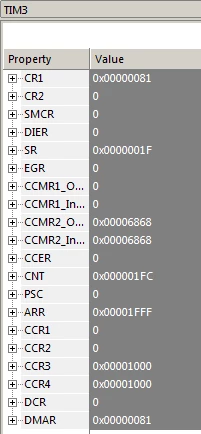

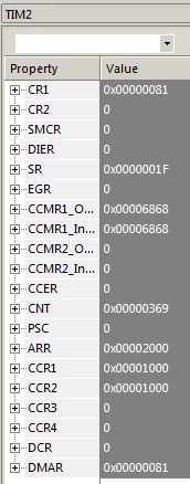

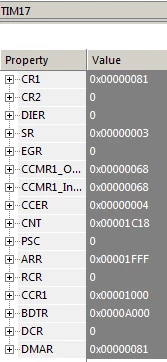

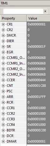

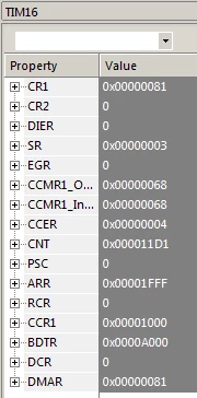

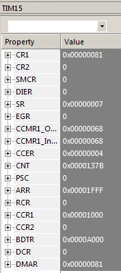

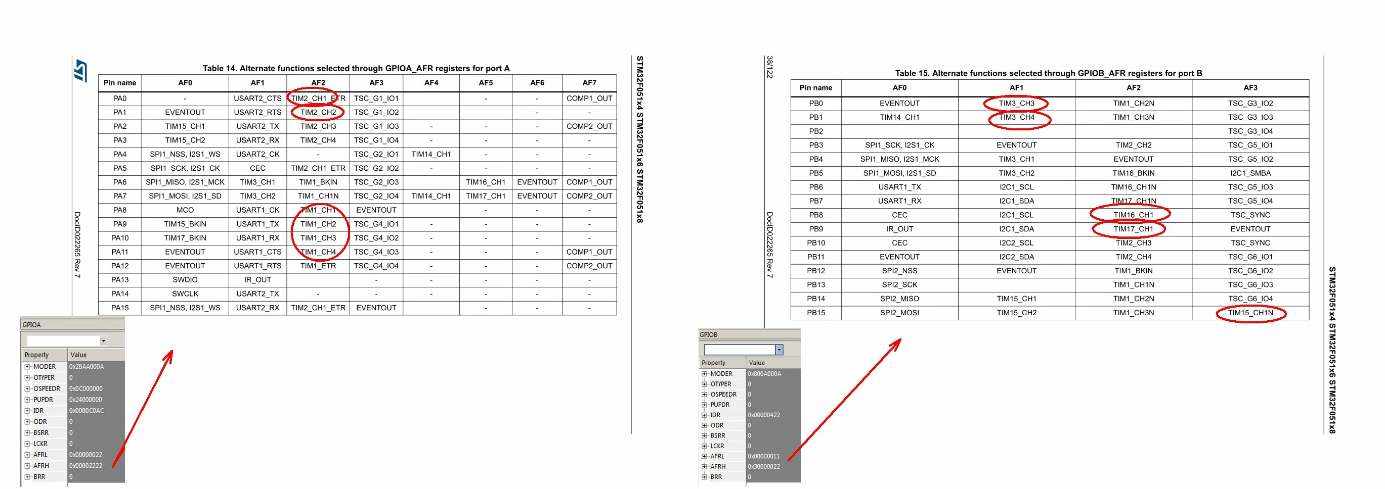

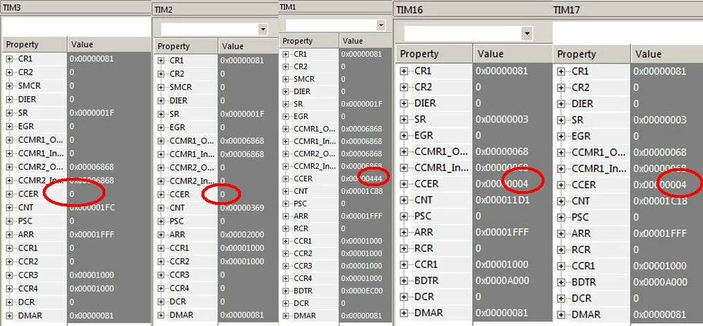

STM32F051C8 TIMER1 PWM NOT WORKING?
HI
stm32f051 config with stmcubemx
but, timer1 and timer2 and timer3and16and17 not working for pwm generation
only timer15 good work
why????
waclawek.jan
waclawek.janBest answer
Feb 28, 2020 1:44 AM UTC
You enable only the "inverted" of the complementary channels (TIMx_CHyN), look up the CCER register's description in RM:
TIM2 and TIM3 don't have complementary channels, that's why CCER there is completely zero.
However, in the GPIO AF, you have chosen the "direct" channels (without N at the end) - in all timers, except TIM15 - which you say does work.
You enable the "inverted" channels probably using HAL_TIMEx_PWMN_Start(); functions. You have to find some Cube/HAL function, probably similarly sounding, which enables the "direct" channel. I don't use Cube/HAL.

waclawek.jan
Feb 17, 2020 9:59 AM UTC
Read out and check the content of the timer's registers, also check the content of registers of GPIOs related to the pins you want to use for PWM.

waclawek.jan
shose
shoseAuthor
Feb 29, 2020 9:24 AM UTC
HI
Thank you all
especially JW
The problem was solved
HAL_TIMEx_PWMN_Start() function is false
HAL_TIM_PWM_Start() function is true
