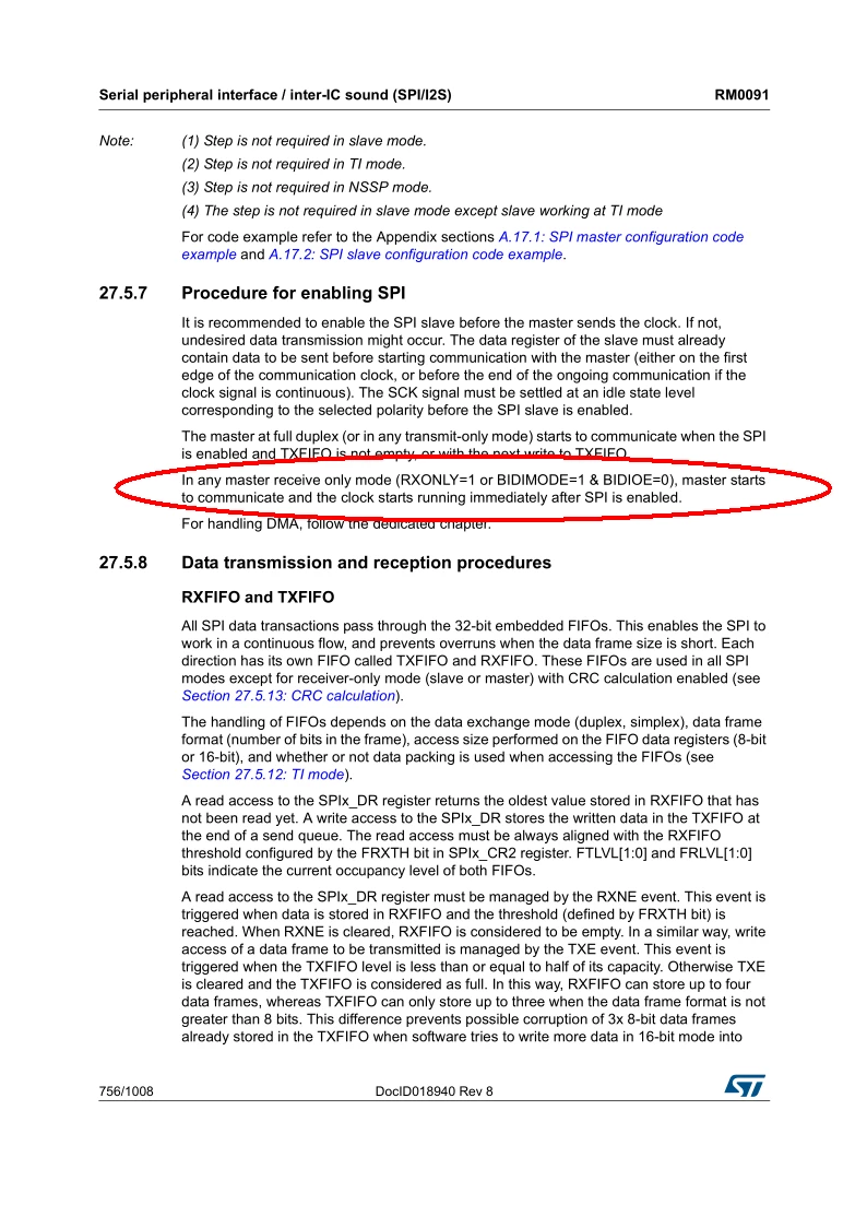

> Problem is, at the moment I set bidirectional line to Rx (line with !!! at the beginning),
> it immediately starts clocking SPI, for unlimited cycles.
That's how the SPI module in STM32 works, and it's quite clearly said in the RM:0690X0000088P2FQAU.png
> Also, on my hardware, other pin is not avaiable, so I hope I can solve it to work internally as half duplex.
Some slaves actually don't care if they see many clocks, except that you have to capture the arriving data fast enough so that the subsequent ones don't overwrite them. DMA might help here.
If your slave requires a precise number of clocks, you can try to carefully emit only one SPI-frame's worth of clocks by turning the direction around, wasting a few machine clocks (NOPs), and turning it back - of course, with interrupts disabled and direct register writes. Wait until the frame ends and datum arrives, read it, and if needed, repeat.

Thank you Jan,
So it is clear, don't need to search for error, it works as it should...
So I will either check the flags to disable once correct amount of data is received, or maybe, as required amount of data is low, and possible speed fast, simply implement a Software SPI, clocking and polling "by code".
