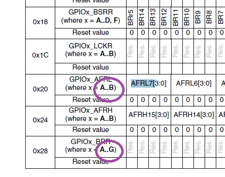

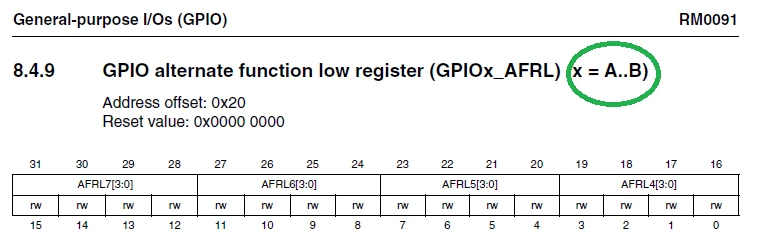

Hello, I try to make I2C on PF6/7 on the STM32F051C6 (48 Pin device) working.
To get what AF to use, Ref man points to the datasheet. But the datasheet is not clear to me, it has a AF Table for PortA and PortB and Table 13 Pin definitions says PIN 35 - - PF6 I/O FT I2C2_SCL PIN 36 - - PF7 I/O FT I2C2_SDA I tried AF0 and AF1 but the chip let me in the dark. The code I have is working on the STM32F0-discovery with I2C1 on PB6/7. Any ideas? Ju #i2c-stm32f051c6
