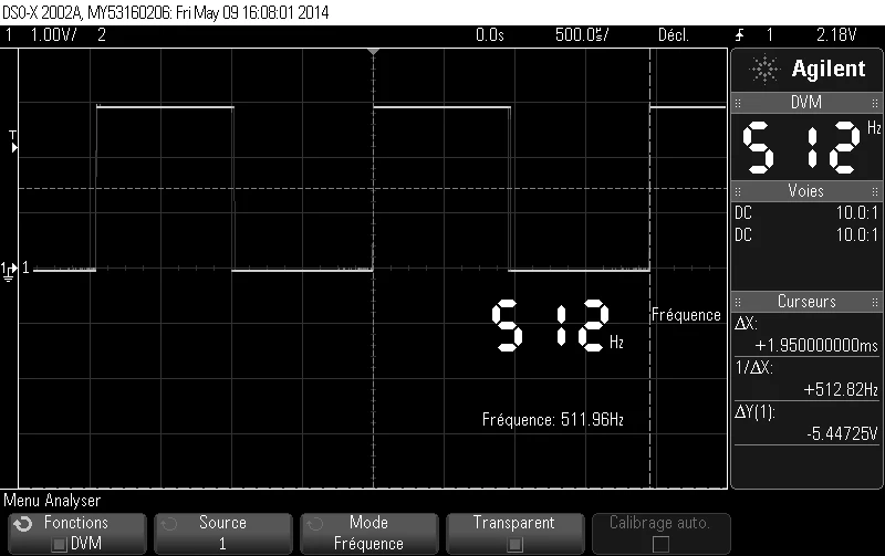

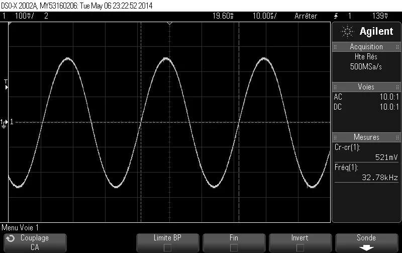

hello,
I am in the
development of a new
application with a
STM32F051R8
.I have a big
problem with
the accuracy of the
RTC:
I
used both
the
quartz
advocate
in the
note
AN2867
application.
I initialize
the
RTC
well
with clock
LSE
I
check
the integrity
of the signal
source
to the oscilloscope
, however
I see
some
burst
even
changing
repeatedly
torque
quartz
capacitor
I have
the same problem
on the prototype board
made
for our
machine
on the
evaluation board
is
why I
excluded
a problem of
PCB
design
After
24 hours
I
observed
a
deviation
which varies
from 60 to
90 seconds
.This deviation
is even more important
if I use
the
timer
2
to generate an interrupt
every
0.1
ms
.I do not see
what can
interfere with
the oscillation of the
quartz
or registers
of the
RTC
, didyou
meet with a
similar case
?Thank you
for your help.
