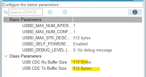

I am using the STM32F042K6 for a small project where I don't have much space. Therefore, I rely on the small package and the "crystal-less USB" function. The hardware arrived today, but unfortunately, I had to realize that the USB library seems to be too large for the chip. I created a new, empty project in CUBE IDE, with only I2C and USB (COM PORT) enabled, and I get the following error message:
"c:\st\stm32cubeide_.2.0\stm32cubeide\plugins\com.st.stm32cube.ide.mcu.externaltools.gnu-tools-for-stm32.10.3-2021.10.win32_1.0.200.202301161003\tools\arm-none-eabi\bin\ld.exe: Test_Project.elf section .data' will not fit in region FLASH'
c:\st\stm32cubeide_1.2.0\stm32cubeide\plugins\com.st.stm32cube.ide.mcu.externaltools.gnu-tools-for-stm32.10.3-2021.10.win32_1.0.200.202301161003\tools\arm-none-eabi\bin\ld.exe: region `FLASH' overflowed by 12 bytes"

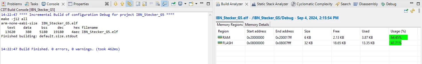

Looks like the CDC is using a lot of RAM. If you change the buffer from 1024 to 512, then it will fit.
  • Hopefully you don't have much user code especially RAM or you'll run into the same issue.
  • You'll have to work with a smaller buffer. Hopefully you don't need to transfer large amount of data.
