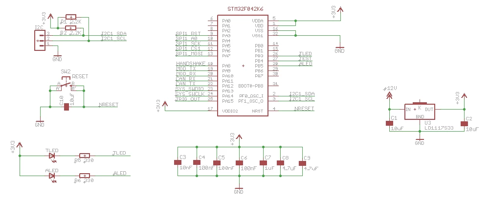

Setup:
I used CubeMX to generate and added code to blink 2 leds and compiled with IAR Embedded.
LEDs are connected to PB3 and PB5.
I have several boards I soldered 042's to with proper caps, and leds with current resisters.
Issues:
STM32F042K6's soldered to QFP to DIP adapter boards and plugged into breadboards work as expected.
Chips soldered to a custom carrier board work 'sometimes.'  If my thumb is over the chip and touching most pins, then code runs good. (Thumb only needed to START code running from reset...)
All STM32F042K6 chips and caps are from same lots.
Any ideas on what I am missing?  Seems like it could be clock related, but I am using internal clock.  PF0 and PF1 are wired to a header with 2,2K pullup resisters to 3V3.
Dan
#stm32f042k6 #problem-solved

Well much more probable supplies over clocks.
Make sure you've got all your supply pins hooked up, even the analogue ones. The analogue ones have the power on reset circuitry. Check the state of NRESET, and BOOT0 pins.
Not clear from the description if the parts not running, or your codes not running. I'd opt for something really simple that didn't require the clocks and PLLs turning on.
Other than that you might want to share a schematic, or portion thereof

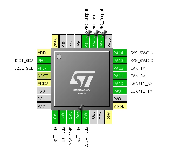

dan
danAuthor
Dec 11, 2014 10:05 PM UTC
Posted on December 11, 2014 at 23:05
Code inserted into generated CubeMX output is:
/* USER CODE BEGIN 3 */
/* Infinite loop */
while (1)
//HAL_IWDG_Refresh(&hiwdg);
for(u32Delay=0;u32Delay<0xFFFF;u32Delay++);
HAL_GPIO_WritePin(GPIOB, GPIO_PIN_3, 0);
HAL_GPIO_WritePin(GPIOB, GPIO_PIN_3, 1);
HAL_GPIO_WritePin(GPIOB, GPIO_PIN_5, 0);
HAL_GPIO_WritePin(GPIOB, GPIO_PIN_5, 1);
/* USER CODE END 3 */
Tesla DeLorean
Guru
Dec 11, 2014 11:42 PM UTC
Posted on December 12, 2014 at 00:42
Yes, would like to see a pull-up resistor on the NRST pin (it's an open-collector driver) so that it has some chance of going high as it charges, and a pull-down on BOOT0

Pg 82 of the datasheet says there is an Permenant Pullup on the nreset pin.  Also, I have monitored the voltage across the cap I have installed there and it takes about a second to reach 3V3.  Looking into the BOOT0 pin now.
dan
danAuthor
Dec 12, 2014 1:14 PM UTC
Posted on December 12, 2014 at 14:14
Turns out that the PullDown for BOOT0 was the problem.  Of course I neglected to bring the pin out to a pad or anything...  $40 and that is solved.
Thank you Clive for your help with this issue.  It was driving me up the wall!
Dan
