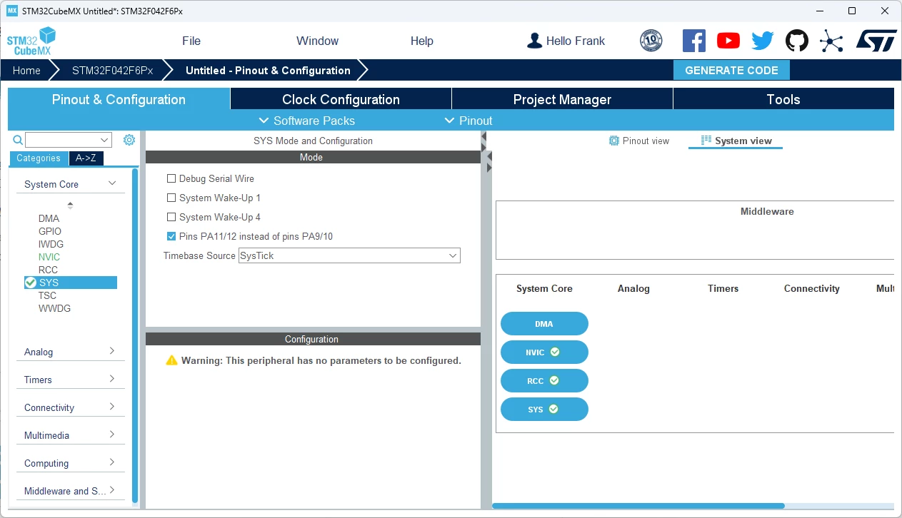

Im trying to use CAN on an STM32F042F6P6. The datasheet tells me to remap PA11/12 to PA9/10. How would I do that in CubeMX?
https://www.st.com/resource/en/datasheet/stm32f042c4.pdf
If I hover over the grayed out CAN, it tells me that I have to do this in "SYS". Id assume this means the System View, however that doesnt really bring me any further either.

no, it is SYS category on the left:
hth

Found it, thank you.
