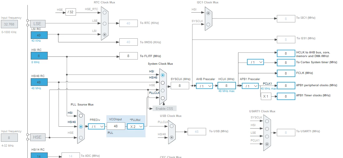

My Clock Settings
SergenBest answer
October 26, 2024
I solved the problem. Unfortunately, the microcontroller I bought was either fake or broken, so my values ​​were wrong. I changed my microcontroller 2 days ago and the problem was solved.
