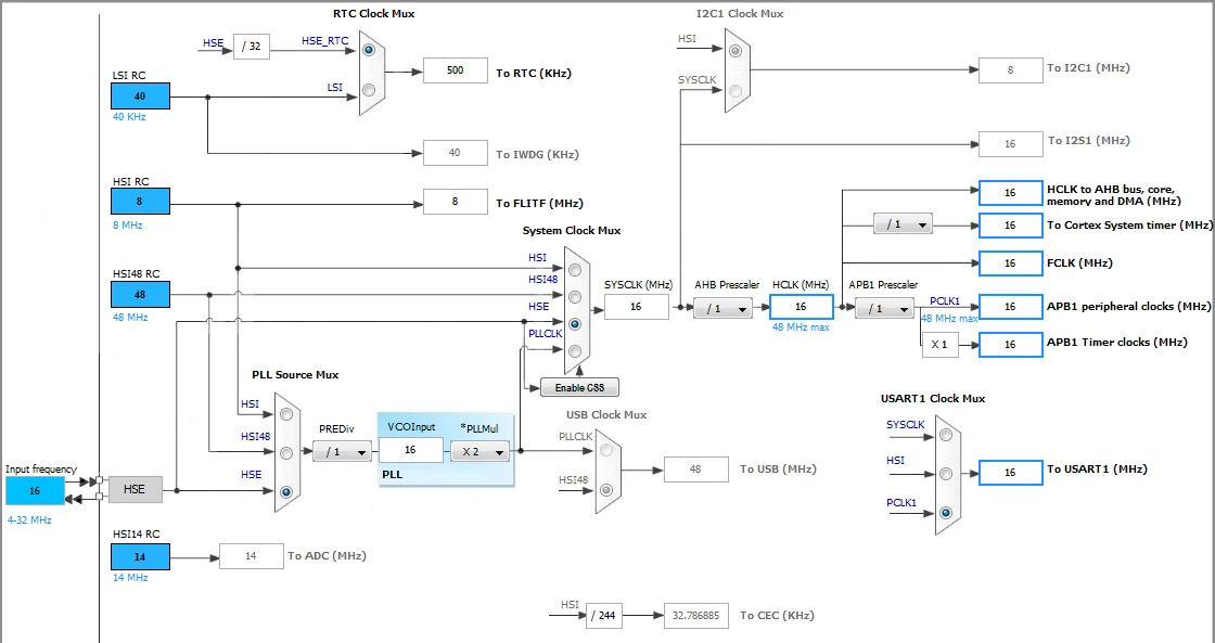

Hi, I'm here again! Now I put an external 16MHz oscillator. I measured the frequency of the crystal with the oscilloscope and seems to be all right. But now I have an error of 12 minutes to every 24 hours. My application is totally dependent on the correct RTC and should work for 45 uninterrupted days.So I wonder if this error is normal for an external crystal or there may be something wrong with my settings.

hrtc.Init.AsynchPrediv = 125;
hrtc.Init.SynchPrediv = 4000;
 Are you sure?
 Consult the RTC prescaler register chapter in RM, and Cube's manual's RTC section.
engenharia2
March 30, 2016
Posted on March 30, 2016 at 15:08

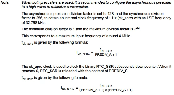

 Thank you JW, it's my fault. The dividers starts from 0. Probably this is the problem isn't?Now I will test with this setting:   hrtc.Init.AsynchPrediv = 124;
hrtc.Init.SynchPrediv = 3999;  Unfortunately I cannot configure the asynchronous prescaler to a high value because it will generate a small error.  For reference below the RM0091p573/1008 note:  0690X00000605KHQAY.png
