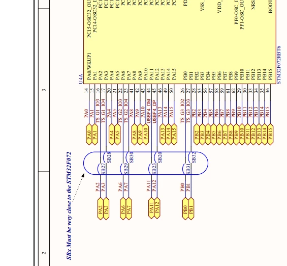

Hi Clive ,
I'm using the STM32F072 discovery board. In that i'm using the CAN peripherals CAN_Tx and CAN_Rx .
Below is the circuit diagram of my connection.
 I'm using MCP2551 trans-receiver. when i'm trying to send the CAN frame i'm getting the ''bit dominant error''.
I have monitored the CAN_ESR (CAN error status register) in that Last error code (LEC) i got the count 101=> which indicates the ''Bit dominant error''. I'm not understanding the what goes wrong , i have shared the code also please help me if any body is having the solution for this.

    I am not sure if
    MCP2551 is a CAN transceiver, which can work with STM32 MCUs.
    I saw many CAN buses with MCP2551, but these CAN
    transceivers were connected to 5V MCUs, which in fact means that MCU's and tranceiver's CAN_RX and CAN_TX logic was 5V.
    I saw also many CAN buses with STM32 MCUs, but here always CAN transceivers were also supplied with the same voltage as MCUs. For example all STM32 eval boards use TI's SN65HVD230 3.3V CAN tranceivers. As a result both MCU and CAN transceiver are supplied with 3.3V and their CAN_RX and CAN_TX logic is 3.3V.
    In your design you use STM32F072, which can be supplied up to 3.6V and MCP2551, which is supplied with 5V. I would propose to double check that these devices can work together.

    I got solution for my issue. Issue was not the 5volt or 3.3 volt supply.
    Issue was i'm using the PA11 and PA12 pin for CAN_Rx and CAN_Tx i checked the schematic, i found that to access the PA11 and PA12 pin i need to short the SB link i.e SB20 and SB23 on the board.
    Now its working fine. Thanks for your time buddy.
