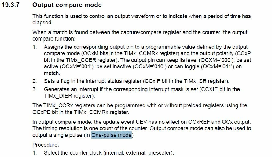

Vangelis Fortounas
Jan 20, 2021 11:49 PM UTC

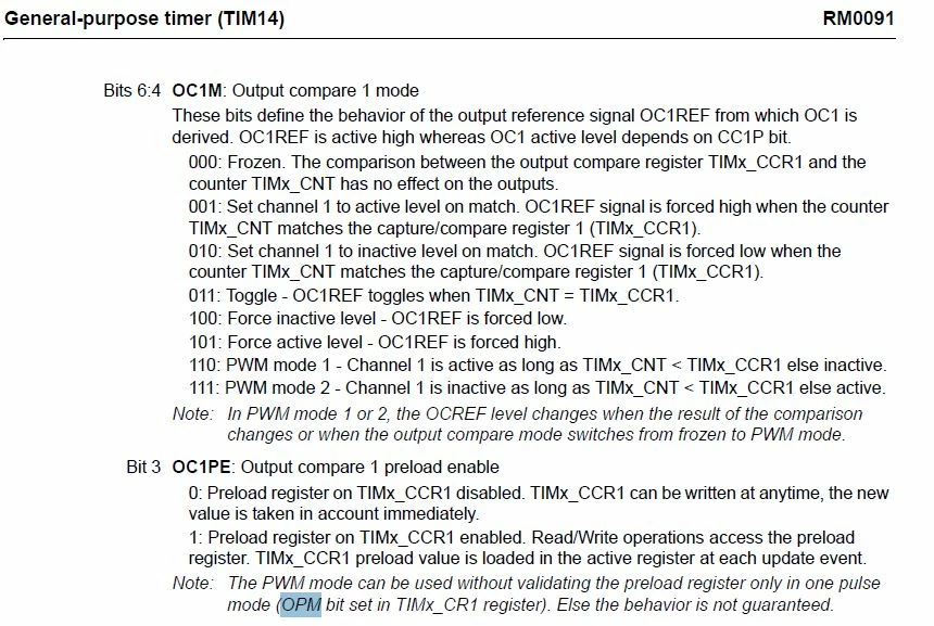

In page 468 OPM is mentioned0693W000007C5MTQA0.jpgAlso in page 474
