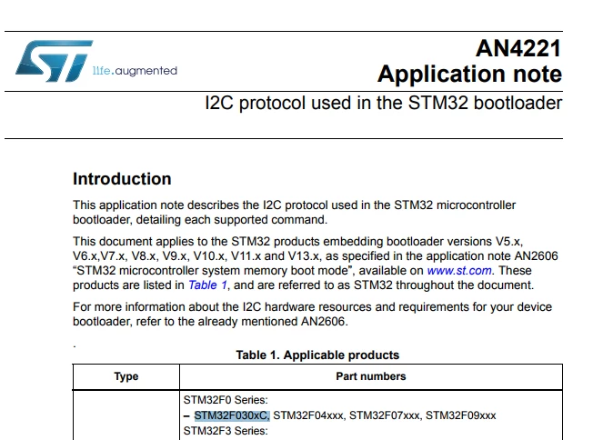

STM32F030xC Boot Loader Options
  • November 21, 2017
  • 1 reply
  • 710 views
Posted on November 21, 2017 at 15:04
Does the STM32F030xC support interfacing the boot loader over I2C?  The datasheet does not list this as an option but it is listed in AN2606 over port I2C1.  Which of these are correct?
    1 reply
    November 21, 2017
    Posted on November 21, 2017 at 17:07
    Th
    e STM32F030xC support the I2C bootloader as described in the AN2606 and AN4
    Best Regards
    Imen
