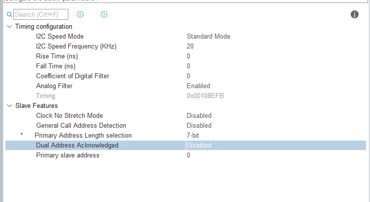

I am using STM32F030RC and I have connected ST's EEPROM IC M24M01-RMN6P over I2C interface on I2C2.
I have following configuration on STM32CubeMx -
I have selected PA12 -I2C2 SDA and PA11 - I2C2 SCL pin configurations.
I am using 4.7 K resistors as pull-up.
However, I am not able to communicate with EEPROM. I checked on DSO, no waveform is being seen on SDA and SCLK pin.
I have previously used I2C successfully on I2C1.
Is there more configurations required for I2C2?
Where am I going wrong?
