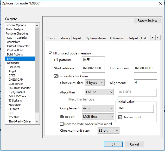

I want to add crc function for the IAP-APP function. So I used the CRC example inSTM32Cube_FW_F0_V1.9.0 to test. But
uwCRCValue
is always 0. I think theuwExpectedCRCValue
should be the last four byte (0x0803FFFB-0x0803FFFF
), anduwCRCValue
should be the same value. Attach is the IAR configuration for CRC. Did my understanding wrong or my code below is wrong?#define BUFFER_SIZE 114

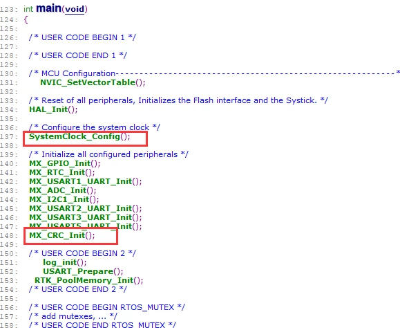

{ CrcHandle.Instance = CRC;/* The default polynomial is not used. It is required to defined it in CrcHandle.Init.GeneratingPolynomial*/
CrcHandle.Init.DefaultPolynomialUse = DEFAULT_POLYNOMIAL_ENABLE;/* Set the value of the polynomial */
//CrcHandle.Init.GeneratingPolynomial = DEFAULT_POLYNOMIAL_ENABLE;/* The size of the polynomial to configure the IP is 8b*/
CrcHandle.Init.CRCLength = CRC_POLYLENGTH_32B;/* The default init value is used */
CrcHandle.Init.DefaultInitValueUse = DEFAULT_INIT_VALUE_DISABLE;/* The input data are not inverted */
CrcHandle.Init.InputDataInversionMode = CRC_INPUTDATA_INVERSION_NONE;/* The output data are not inverted */
CrcHandle.Init.OutputDataInversionMode = CRC_OUTPUTDATA_INVERSION_DISABLE;/* The input data are 32 bits lenght */
CrcHandle.InputDataFormat = CRC_INPUTDATA_FORMAT_WORDS;if (HAL_CRC_Init(&CrcHandle) != HAL_OK)
{ /* Initialization Error */ Error_Handler(); }}
void APP_CRC(void)
{ /*##-2- Compute the CRC of 'aDataBuffer' ###################################*/ uwCRCValue = HAL_CRC_Calculate(&CrcHandle, (uint32_t *)&aDataBuffer, BUFFER_SIZE); TRACE_DBG_STRING(DEBUG_MODULE, LOG_LVL_INFO, 'APP_CRC: %x,%x', uwCRCValue,uwExpectedCRCValue);/*##-3- Compare the CRC value to the Expected one ##########################*/
if (uwCRCValue != uwExpectedCRCValue) { /* Wrong CRC value: enter Error_Handler */ TRACE_DBG_STRING(DEBUG_MODULE, LOG_LVL_INFO, 'CRC err');//Error_Handler();
} else { /* Right CRC value: Turn LED2 on */ TRACE_DBG_STRING(DEBUG_MODULE, LOG_LVL_INFO, 'CRC success'); }}
