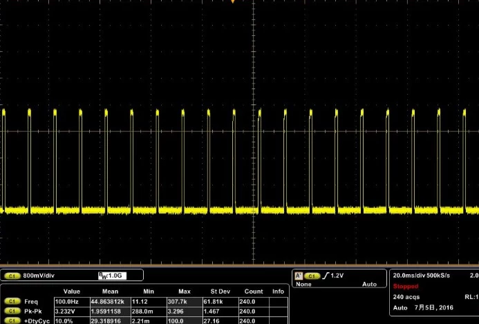

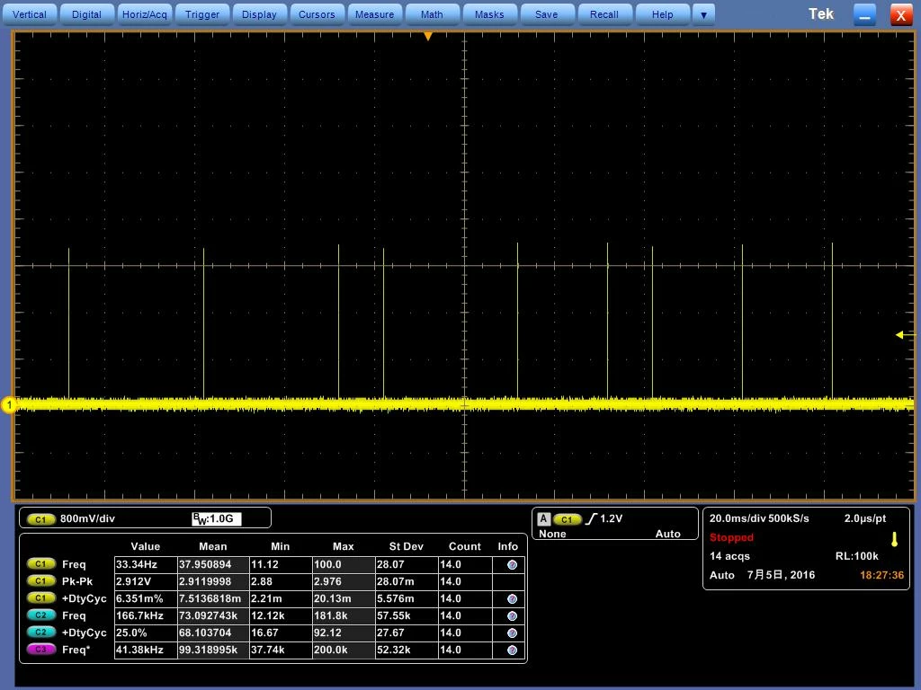

I've encounter a issue about setting Time base on STM32F030R8.
I used TIM14 to be time base.
When I check the 10ms time base in stm32f0xx_it.c.
That was worked normally.
But, I used it to set time flag in main.c
It's worked abnormal.
The waveform isn't regular(not 10ms waveform).
How do I solve it?
Please help me.
Thank you.
Code is as below:

Not sure exactly what's going on here, but your variable needs to be volatile. I'd recommend toggling the GPIO at each event.

The OP is clearly not using HAL/Cube. Examples exist within the SPL, and on the forum.
I'd test this by toggling a GPIO, and not having it running under a debugger. I'm not sure why the trace has missing pulses, but I'm not willing to spend my time diagnosing it.

Hi clive1, Hannibal and dembek.radoslaw.001
I make a mistake in TIM14_CCR_VAL.
It should be set volatile not define in a file. (But, IAR don't show any error or warning before change the variable).
After that, it still lose the pulse waveform(I used the example code from en.stsw-stm32140).
Thank you for your reply.
