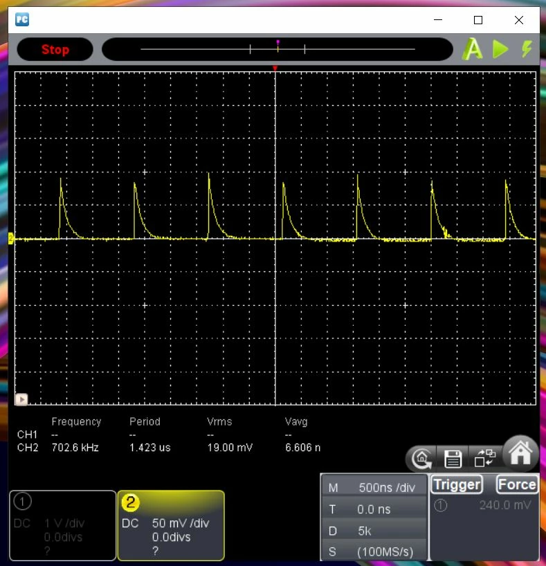

STM32F030K ADC injects voltage on pin
Hi, Can anybody help to point out why the pin voltage on adc input goes high as soon as i start the adc. When I connected a 10K resistor between AIN1 and GND (VDDA=VDD=3.3V), the voltage dropped to 1.6V. I tried HAL_ADC_START , Start with IT , DMA and calibration, but the voltage returns. I added 2 Sec delay for debug and verified the thing occurs when start command is given..

waclawek.jan
Dec 25, 2020 1:31 PM UTC
This is normal. You have to use low impedance signal source.

ManishNair
Dec 26, 2020 2:59 PM UTC
Hi Tdk,
"What voltage? PA0? VDD?" - PA1 voltage
PA1 is configured as AIN1 and this pin is pulled down via 10K res.
The ADC reads this input and gives correct voltage... I fed this input with a potential divider (of course 10K pulldown is also considered in design) for voltage measurement in one unit and across a 0.05Ohm shunt with 5K trimpot for current measurement. The Voltage on pin PA1 reduces to 20mV in shunt application even in no load..
Please refer the attached wave form. Connection - 1K resistor and 0.1uF Capacitor in parallel, connected across AIN1(PA1) and GND.. It shows some sort of differentiated wave.
TDKBest answer
Dec 26, 2020 3:24 PM UTC
Ah, so it's a transient spike and the voltage tends to zero during sample and hold period. This is expected. Your sampling period (under 3us) is pretty small, so you'll need to ensure the source is sufficiently low-impedance.
Looks like a 1K resistor is okay, but 10K is not.
ManishNair
Dec 26, 2020 4:44 PM UTC
Thanks TDK,
The problem solved with 1K res and 239 cycles... Still the transient is there but averaging with DMA overcomes it.. Thank you for your kind support
