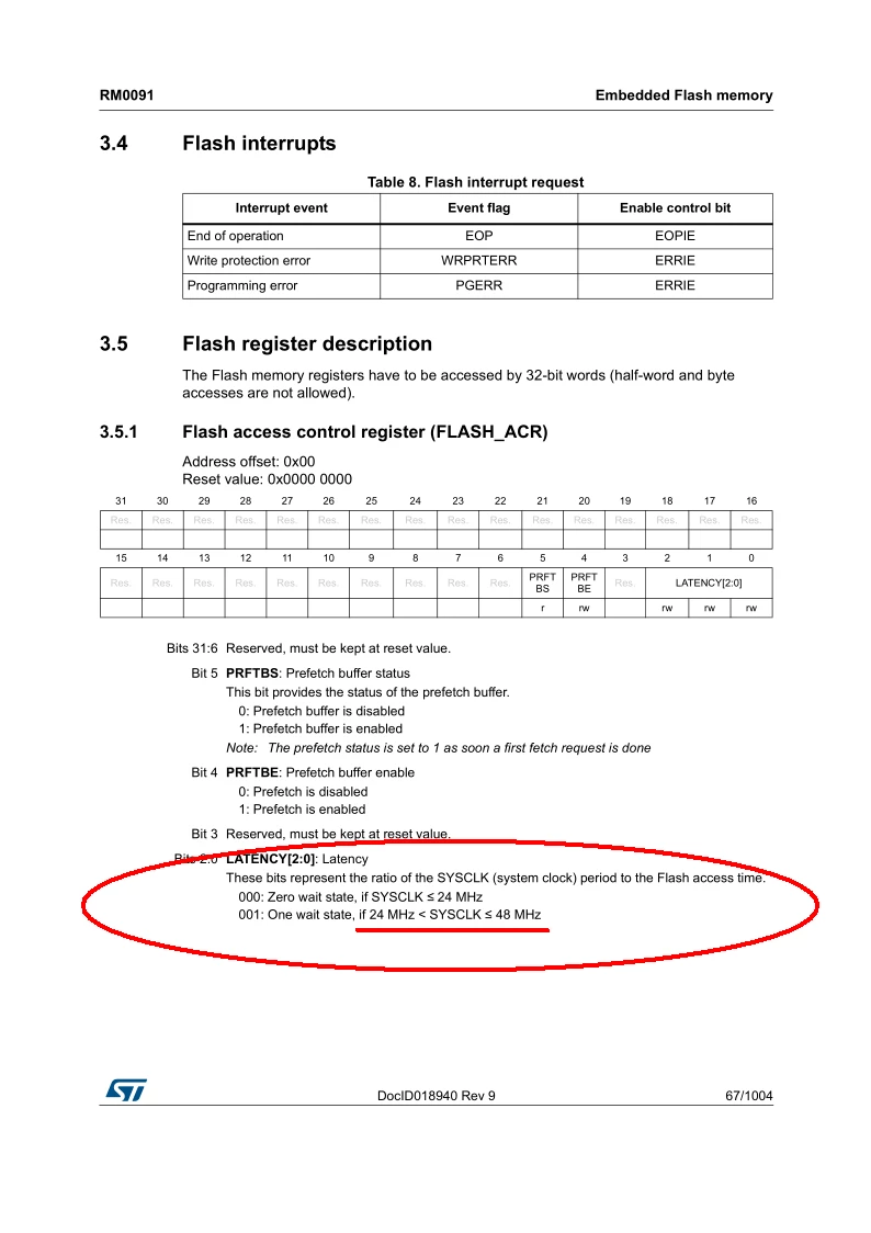

Lyu.1
Lyu.1Author
Senior
Apr 18, 2020 2:55 PM UTC
Hi,Master:
Thank you very much for your authoritative answer. I still have a few questions and I need further help:
Question 1:
In the clock tree in the screenshot I took earlier, HSI is directly used as PLLSRC. There is no frequency divider in the middle of this.I didn't understand how this frequency divider 2 came out?
Question 2:
The LATENCY of the FLASH_ACR register you mentioned, I refer to the description in the manual, and I don't really understand its meaning. Is it necessary to set it to 1 when the system clock is above 24M, what does this value mean? I used to use stm32f030c8 as the default value (0), But there was no problem.
Question 3:
Your answer mentioned: "HSIRDY should be checked before configuring the PLL to use it, but it's probably running since reset anyway."
Should it be like this?
 /* Wait till HSI is ready */
 while((RCC->CR & RCC_CR_HSIRDY) == 0)
 RCC->CR |= ((uint32_t)RCC_CR_PLLON);
 /* Wait till PLL is ready */
 while((RCC->CR & RCC_CR_PLLRDY) == 0)
thank you very much!

Q1: As berendi said, if you select PLLSRC=0, input to PLL is HSI/2 - the PREDIV in the diagram in your screenshot is forced to 2.
Q2: The internal FLASH is too slow to run at 48MHz, so accesses to it have to be slowed down by the FLASH controller, that's where the latency setting comes into play:
 FLASH->ACR = (1 << FLASH_ACR_LATENCY_Pos) | FLASH_ACR_PRFTBE; // 1 cycle latency, + switch on prefetch
berendi
