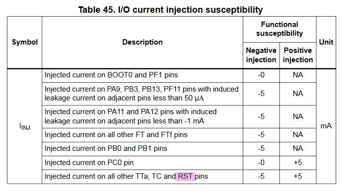

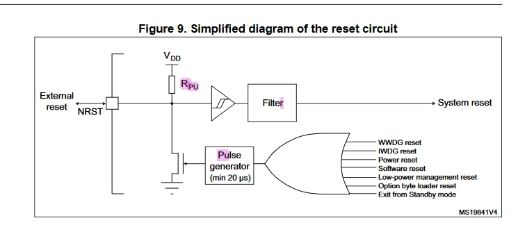

Does anyone know what kind of current draw the pulse generator on the NRST pin of the stm32f030CC is meant to handle.
as far as i can tell its 5ma
The reason I ask is that our circuit on the NRST pin allows the stm32f091 to reset the stm32f030CC using a GPIO set to PP_OUTPUT through a 1k2 resistor, with an additional 10k pullup and im wondering if i might be damaging the pulse generator on some IC's. An example of what we have done is shown below
I dont think that this would draw enough current to cause any issues when the NRST pin is pulled down internally but am interested in what everyone thinks.

i dont think, you damage something with driving nrst by 1k2.
But for the connected st-link : it has to fight against this, to get nrst low.
Just try: setting the F091 pin to open drain output; this way you can reset the F030 as before,
but only the 10k is active as pullup. I would do it this way.... :)

@Luke Iliffe You also don’t need a pull-up of 10k (even if some Asian board manufacturers keep adding this) as there is an internal one behind NRST. However, I would still add a 100nF capacitor to NRST to suppress interference pulses.

just remove those 2 resistors and see if you can connect now. my guess is that the chip is under reset all the time
