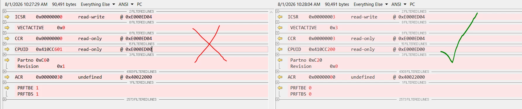

i have read all register of both MCU good and not good
key difference found is  below figure.
all perpheral rister difference table left one not good write one good

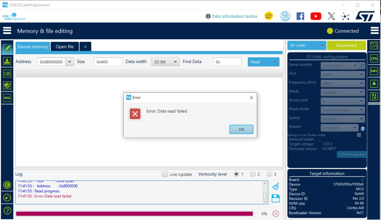

i also observe when i connect MCU with stlink v2 in stm32cubeprogrammer
Good MCU
  • bootloader version is 0x21
  • show eror on reading flash memory

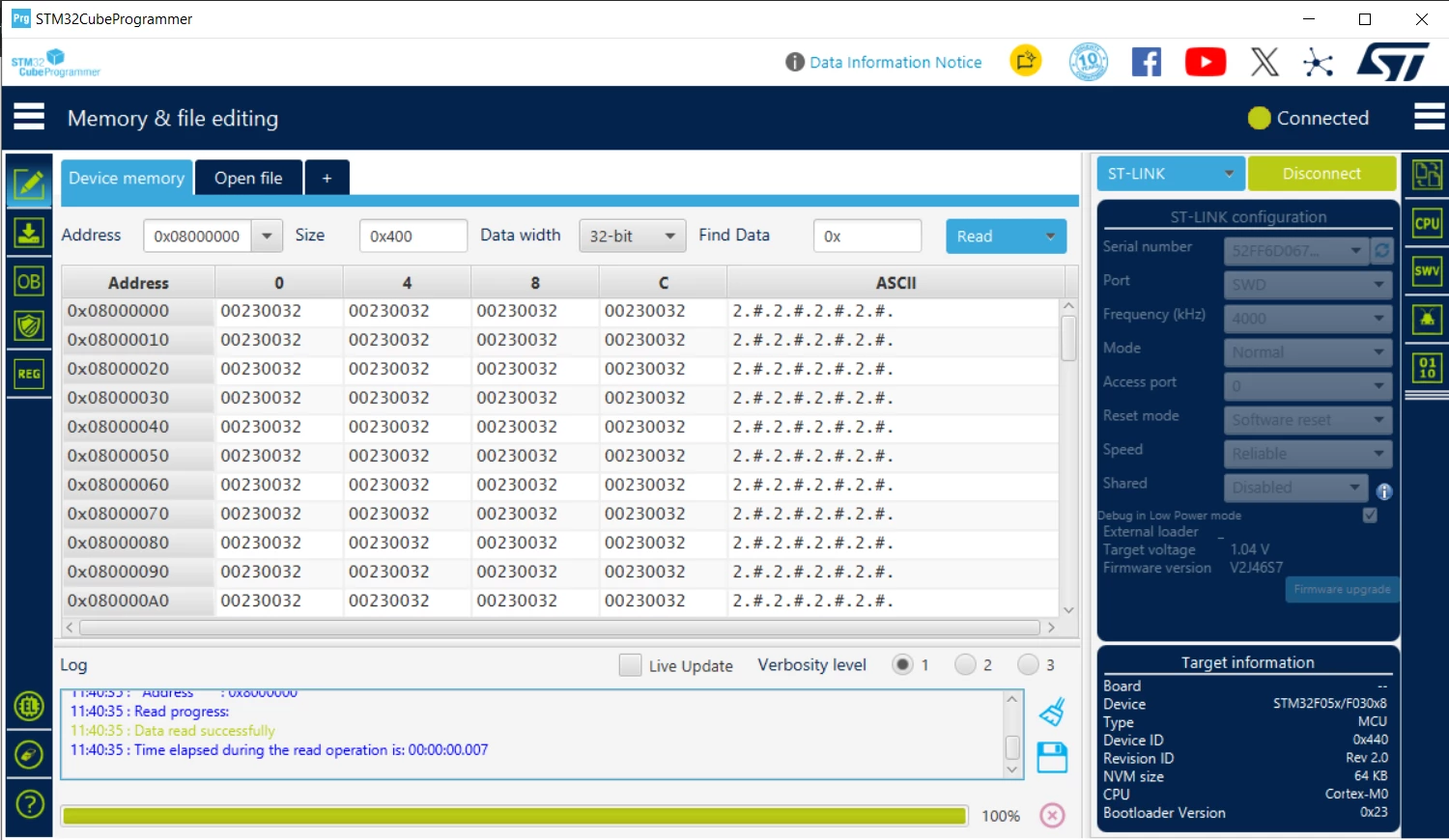

NOT Good MCU
  • bootloader version is 0x23
  • read flash memory while RDP level 1 was active and show same pattern values

now how can i solve this issue?

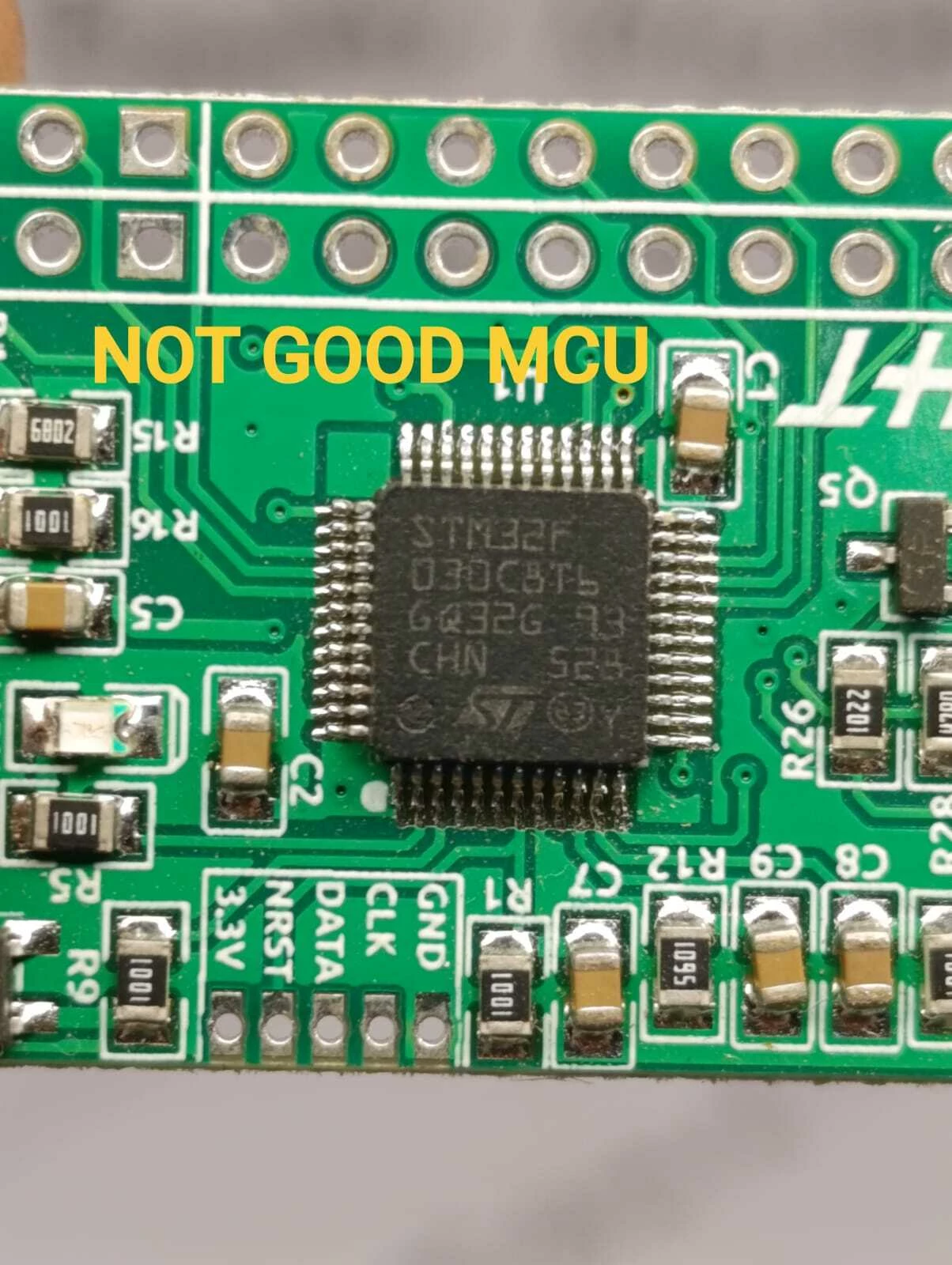

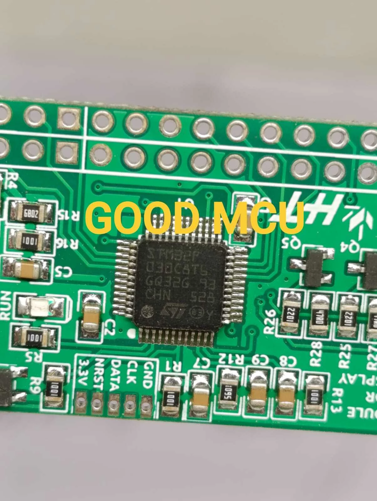

Maybe the Cube programmer does not really read out the processor’s CPUID and just infers the core from the mcu type, i.e. value read out from DBGMCU_IDCODE - which is probably 0x440 as expected.
Given the processor core is different than what’s in genuine ‘F0, I am afraid this is a counterfeit chip - a chinese clone marked (or re-marked) as STM32.

Post photos of the chips.
CPUID indicates the “not good” is a Cortex-M0+ core.

now these chips are waste ? or any method to use it ?
waclawek.jan
Aug 6, 2026 2:23 PM UTC
Unfortunately, probably unusable.
