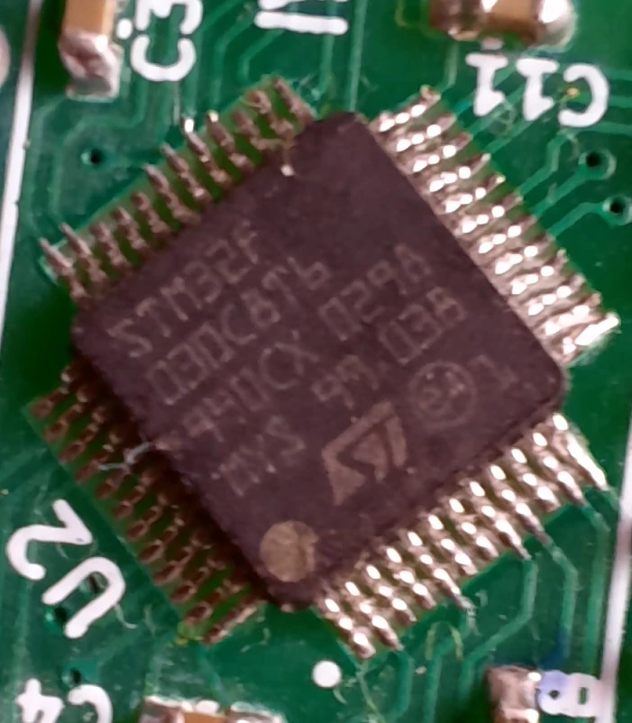

Device Used : STM32F030C8, 48pin LQFP48
I am driving MOC3043 Opto-Isolated Triac Driver so I need atleast 5 mA current sourced from the GPIO output
GPIO used with the MOC3043 is PA15 max current observed is 4.86mA
Only a single GPIO is configured at a time with all other peripherals/pins in reset state.
GPIO is configured as Push-Pull Output with the pull-up/pull-down resistors disabled.
GPIO used to drive a 3mm LED takes around 4mA. Adding multiple LEDs in parallel keeps the total current drawn at ~4.86A
Total current supplied to the STM32F030C8 from the 3.3V DC supply is around 10mA
I tried other GPIO pins like PA12, PB12 but see the same results
I tried several STM32F030C8 ICs from the lot and I see the same results
I even reconfigured the circuit as Open-Drain but still see the current limited to <5mA
I disconnected the STM32F030C8 and directly connected the 3.3V DC supply to circuit driving the MOC3043 input (through a 200E resistor) and the MOC3043 was triggered drawing around 8.3mA
I tried with a STM32F103C8 against the same circuit and it works fine sourcing ~ 8 mA from each GPIO
The F030C8 datasheet states that the max current per GPIO is 25mA and chip max source current is 120mA
Why does my IC limit the single GPIO current to less than 5 mA?
Attached is a pic of the IC. From the pic can we determine if the IC is a fake (not original ST)?
