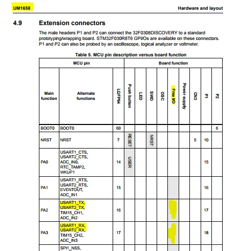

I am having trouble getting some basic USART up and running on the STM32F0308-DISCO board. I have tried both sending and receiving and don't seem to see anything coming through on either end. My code is as follows:
Thanks in advance.

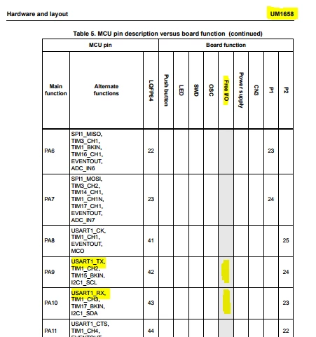

Checking the user's manual of the discovery board there shows that the pins that you are using to uart are free, pages 19 and 20:
http://www.st.com/content/ccc/resource/technical/document/user_manual/ad/36/2c/ad/32/6c/43/27/DM00092pdf/files/DM00092pdf/jcr:content/translations/en.DM00092pdf
By the way, the right pins are PA9 and PA10, there you havean issue.

I have tried PA9/10 with no luck. I have been testing with usb-serial converter, as well as an oscilloscope to verify. I will take a look at CubeMX though, thank you.

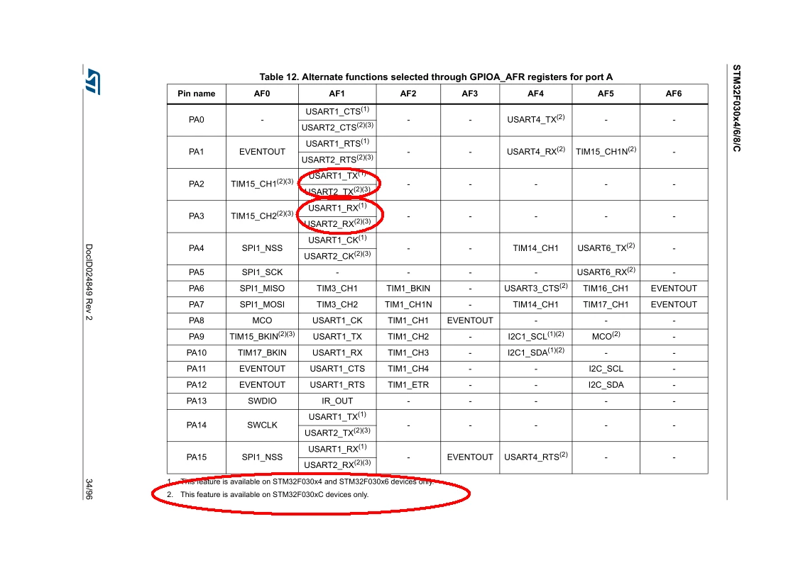

The SPL is a relatively thin abstraction, if you can't get the HW to function with that, then HAL/Cube isn't going to help
The examples posted should output a continuous stream of data. Don't connect anything but a scope probe, and validate the bit timing. Confirm the RX/TX sense is correct. The STM32 TX should go to the RX of another device.
The outputs are at CMOS levels, this is not compatible with RS232 levels. The signals should interface directly with other micro-controllers, or FTDI or SiLabs USB-to-CMOS Serial chips.
For DISCO and NUCLEO boards double check solder-bridge options where signals route to pin headers.

Then some USART1 examples, PA2/PA3 viability will depend on specific F0 part, the Data Sheet covers this.
