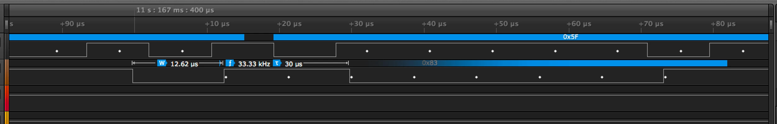

It had worked fine, when the ACK from the F030 was sent after a full block. When sending while there was still incoming data, the start bit of the outgoing data was suddenly shortened a bit, resulting in incorrect data being received in the remote end.

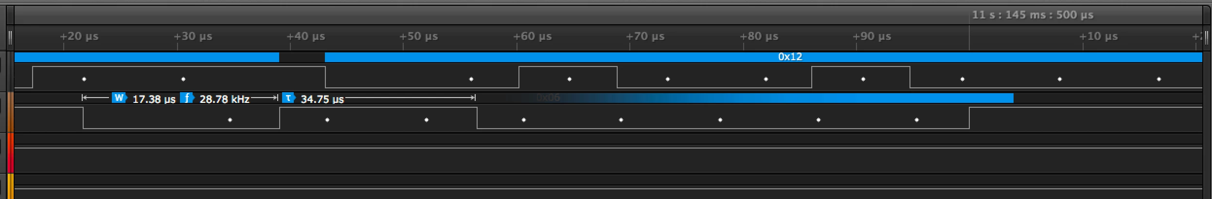

The logic traces show this.
Start bit + one bit should be 17.38us (bit time 8.68us), which can be seen to be correct in the "normal startbit" screenshot. In the "short startbit" screenshot, this time is only 12.62us.
( I don't know if it's actually the startbit or the first bit that is corrupted, but assume it is the startbit). Following bits are all okay.
This causes the 0x06 to be read as 0x83 (as the analyser also shows). I've had a case where it was read as 0x07 instead of 0x06, which could indicate that the bit corruption is not just happening on the startbit.
