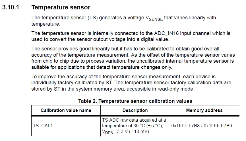

the examples i found are only for other stm chips with 2 calibration values

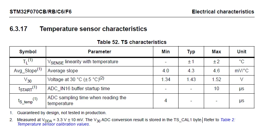

Have you looked at the datasheet:

yes i did but the calculation i tried is wrong
i think its much easier if the datasheet gives some examples

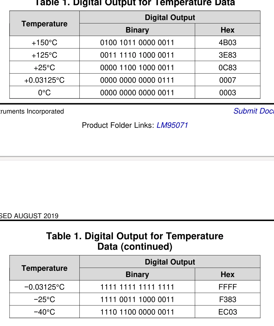

for example from the datasheet of a lm95071
this makes it clear how it has to be calculated
so can you tell me the hexvalue of the ad at 0°C with a vdd of 3.3 V ?

The HAL has macros to help.
In this case ADC_Data.word[2] is the ADC result from reading the Voltage Reference
And ADC_Data.word[1] is the ADC result from reading the Temperature Sensor.
uint16_t refv = __HAL_ADC_CALC_VREFANALOG_VOLTAGE(ADC_Data.word[2],ADC_RESOLUTION_12B);
uint16_t temp = __HAL_ADC_CALC_TEMPERATURE(refv,ADC_Data.word[1],ADC_RESOLUTION_12B);
 The thing that got me was that the Temperature Sensor and the Voltage Reference both need a sample time of 5 microseconds or 160.5 clocks in my case. Way higher than I initially assumed.
