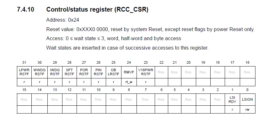

After it resets, what does the RCC_CSR register say about the source of the reset?
ALupp.1
ALupp.1Author
Sep 12, 2020 11:15 AM UTC
If I do not clear the the flags after check one by one, PORRST and SFTRSTF are set. If I clear the flags, SFTRSTF flag is set after reset. I'm using stlink to debug.
A question: when I use the "debug" option in cubeIDE, the code is uploaded and the debug "starts", correct? This can set some of these flags and influencing in the result?
sanju
Sep 12, 2020 4:03 AM UTC
Your code is correct. it doesn't have any error.
Adc is not resetting the microcontroller.
you have to check the source of Reset by reading this register.0693W000003RTjVQAW.png
