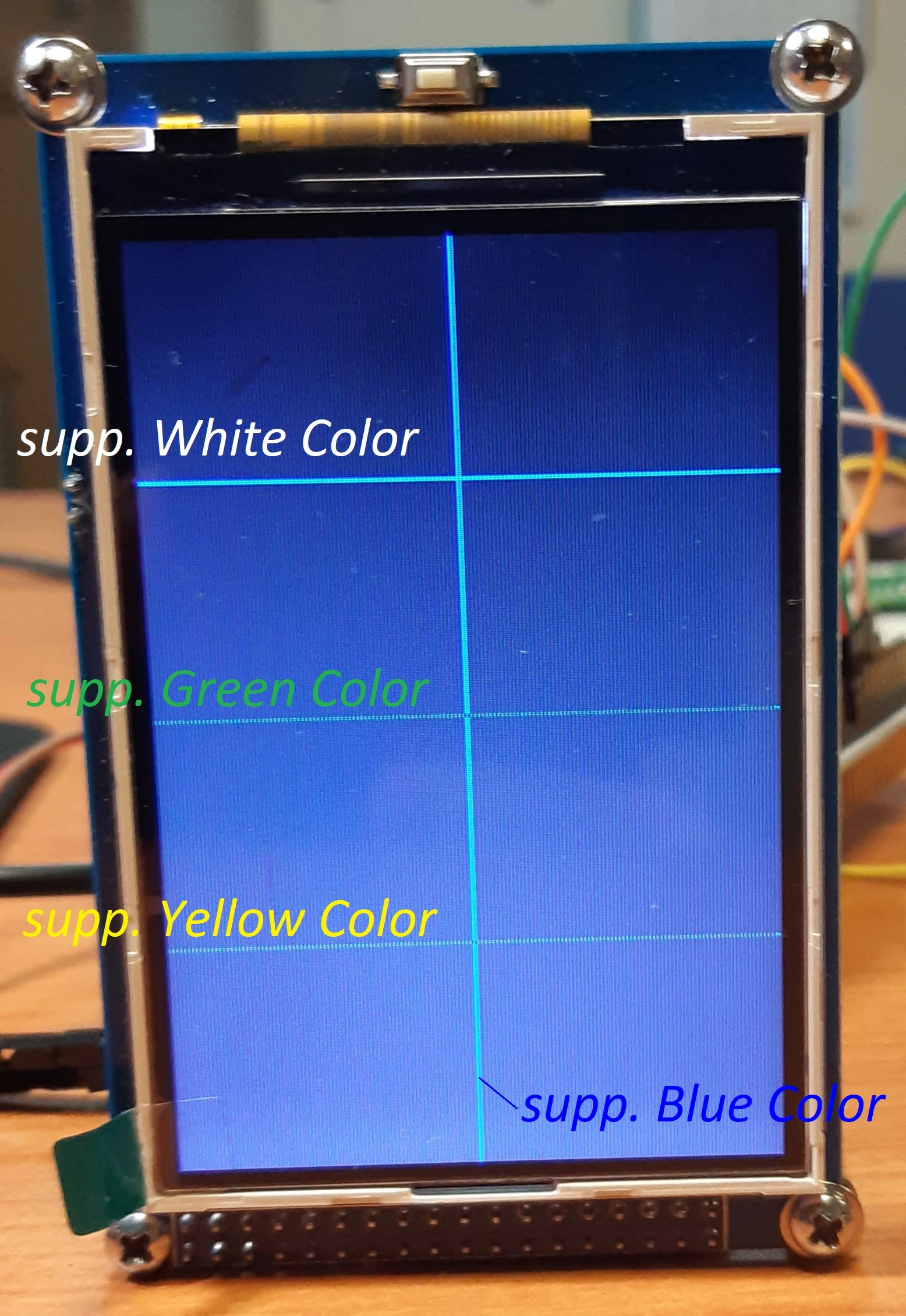

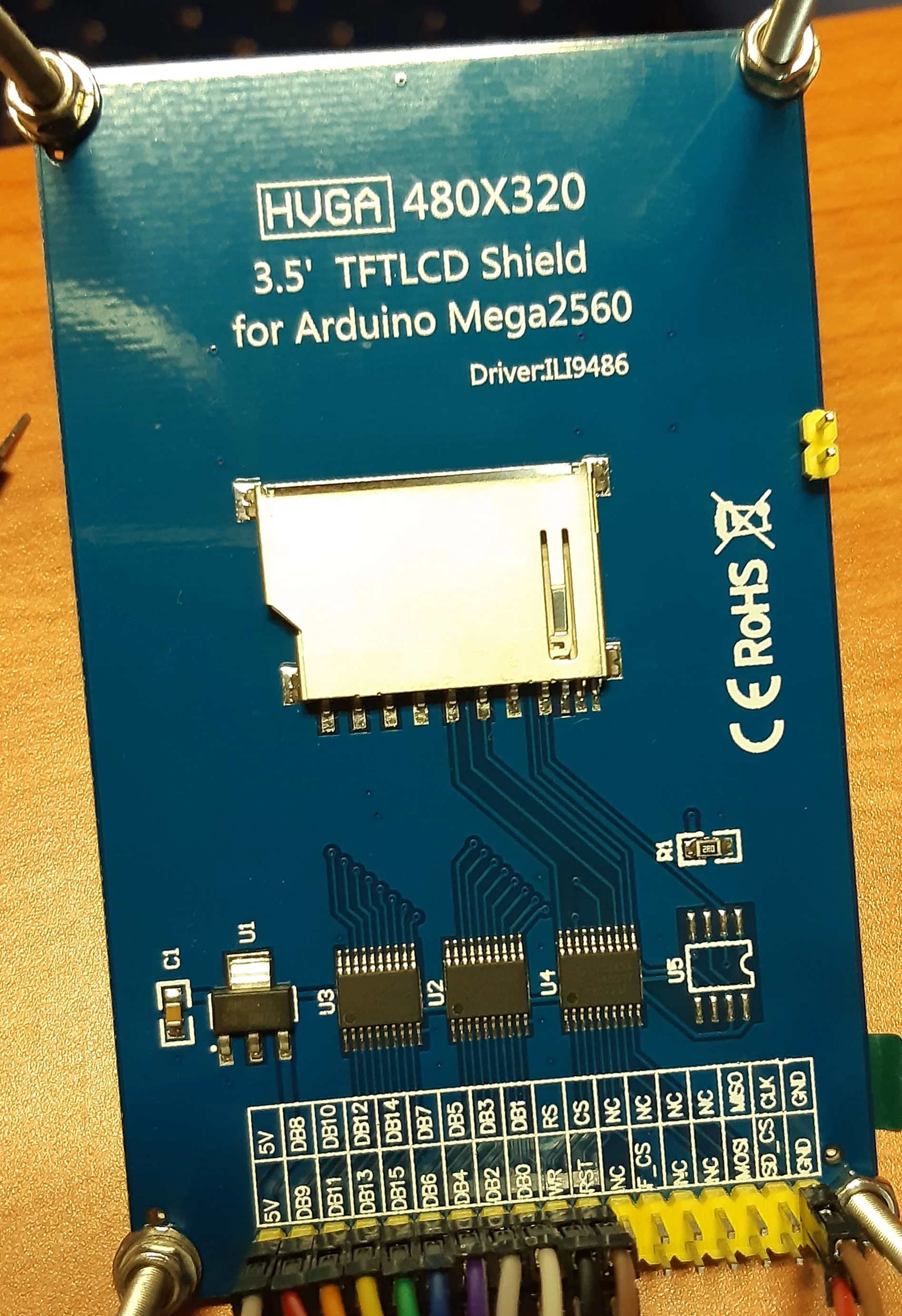

Hello Everyone!
Couple days ago, I tried to interface STM32F030R8T6 dev. board with TFT display like on the picture with ILI9486 driver.
0693W00000HoSrkQAF.jpg0693W00000HoSsiQAF.jpgOne year ago, I interfaced the same TFT with FPGA de board and everything was fine.
With STM32 I tried to interface in 16-bit mode.
This display doesn't has the RDX pin for reading from it. Only Write Operations.
Below my code, which I've started and stuck with strange display behaviour.

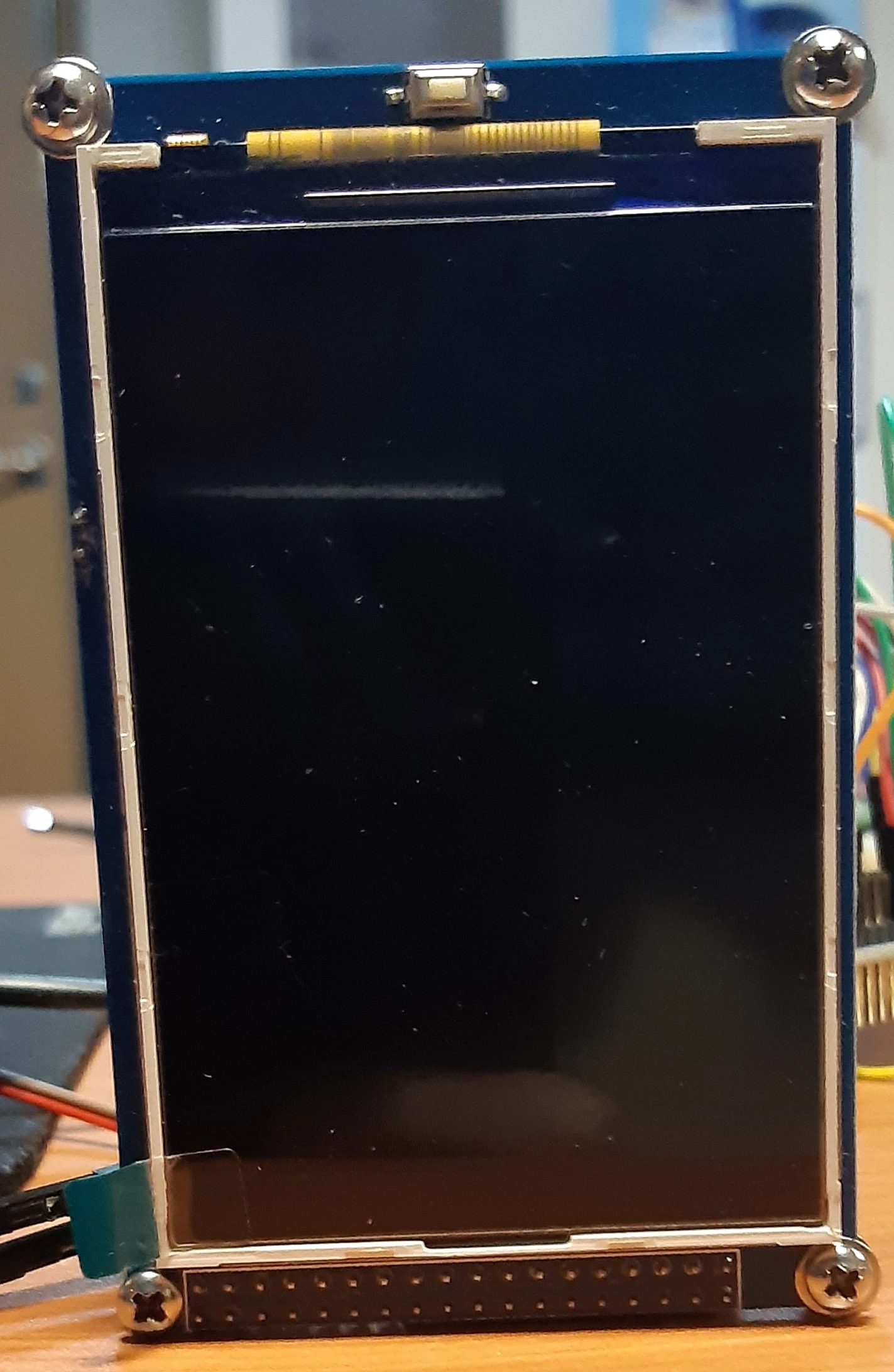

Problem is with colors.
When I set Red Backcolor, the display is shows it as almost Black color.
Green Color it shows as dark Green and Blue Color it shows correct.
So all colors which are close to red, slowly become darker.

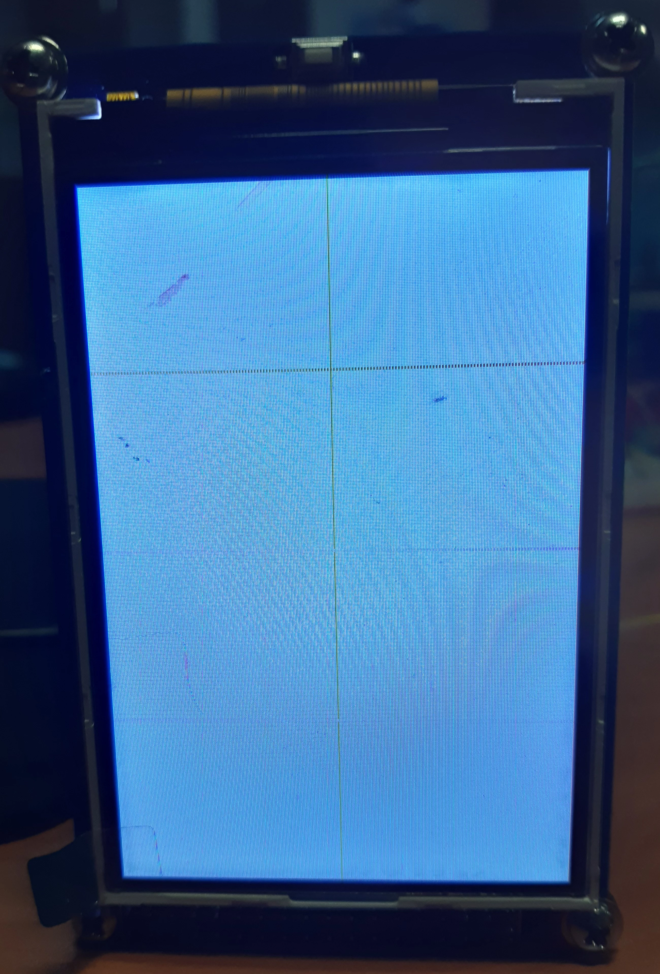

0693W00000HoSuZQAV.jpgI've tried to do Display Inversion mode Command, but it turned everything to Brighter color.
The Blue Color it turned to yellow, Green and Yellow turned to Purple Color, White Color turned to Orange.
0693W00000HoSvXQAV.jpgI understand, I did something wrong, but cannot find where.

Did Anyone meet such problem before?
Will apreciate your replies!!!
Thanks in advance.

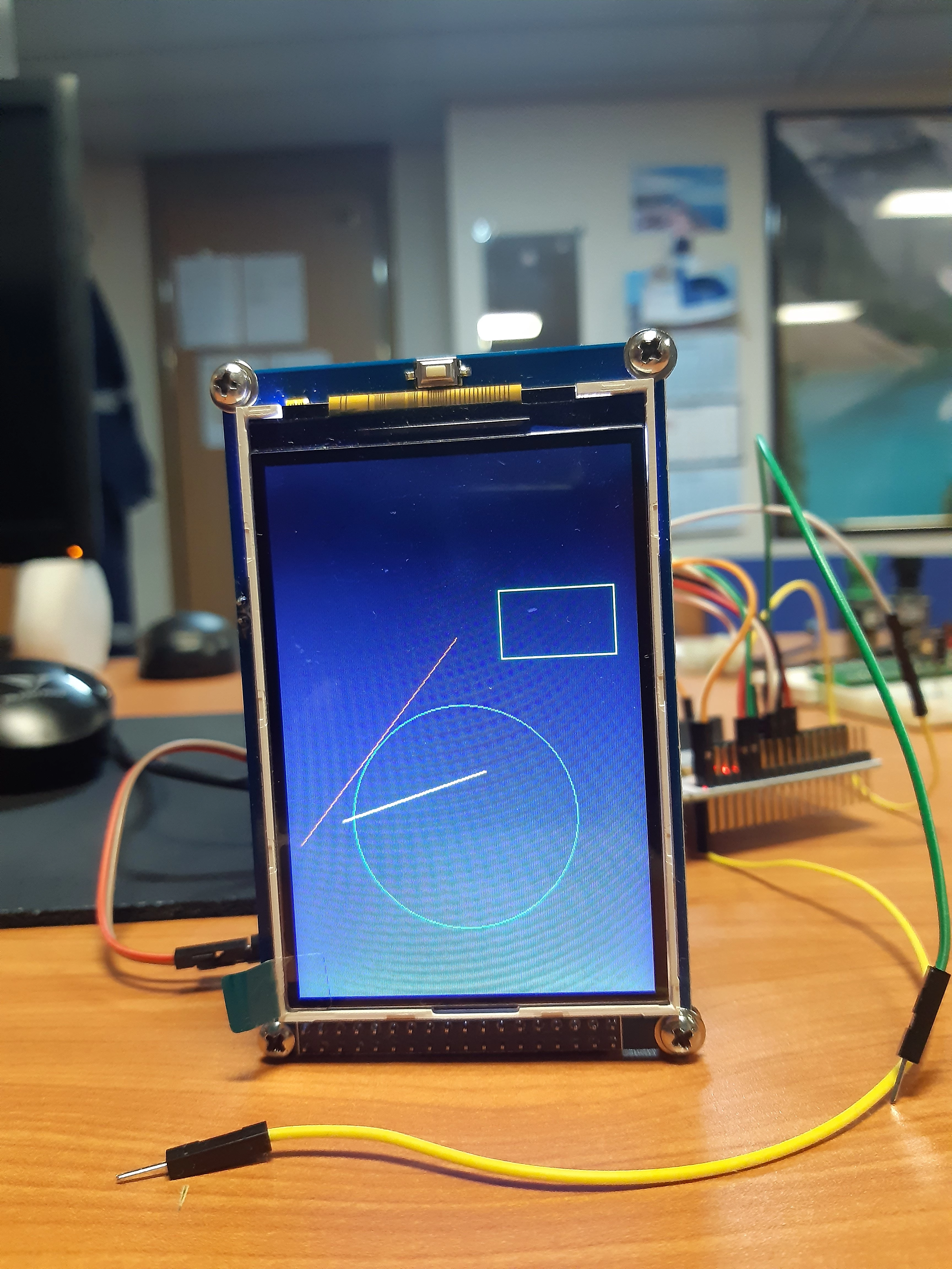

Peter BENSCHBest answer
December 21, 2021
You made at least one mistake:
void TFT_Send_A_2Byte_To_TFT_DataPins(uint32_t character)
	HAL_GPIO_WritePin(TFT_D0_GPIO_Port, TFT_D0_Pin, 	character & 0b0000000000000001);
	HAL_GPIO_WritePin(TFT_D1_GPIO_Port, TFT_D1_Pin, 	character & 0b0000000000000010);
should be more like (you forgot to move the bit to position 0 after masking):
	HAL_GPIO_WritePin(TFT_D0_GPIO_Port, TFT_D0_Pin, 	(character & 0b0000000000000001)>>0 );
	HAL_GPIO_WritePin(TFT_D1_GPIO_Port, TFT_D1_Pin, 	(character & 0b0000000000000010)>>1 );
Please try it out and let us know.

December 21, 2021
Dear Peter!
Thanks a lot!
That's was the reason.
Simply overlooked the shifts after masking.
Now, it's operate as should be. All colors are available.
0693W00000HpQssQAF.jpgI thought, it were either mistake in missed ili9486 commands or some time issues, but the reason was simplier.
So, the problem is solved.
