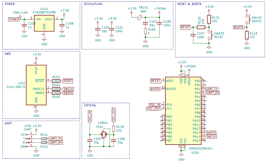

I would like to put STM32F030K6T6 into STOP mode (low power mode), in which there should be current consumption around 5 μA.
But whatever I do the current consumption is around 450 μA in stop mode.
There is basically nothing else on the PCB, it's as simple as possible.
The board without MCU consumes 7 μA, that is quiescent current of LDO. So in the end I would expect to get 12 μA (7 + 5 μA).
When I place there MCU the consumption is around 2-3 mA in normal mode and 450 μA in stop mode.
All pins are set to analog input with no pull-ups, which is recommended config. All peripherals are disabled (like ADC, IWDG, I2C, SPI, timer, etc.). Only RTC is enabled.
I tried it with all pins set to output, it did not help either.
What do I do wrong?

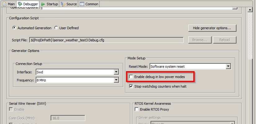

Mar 19, 2022 7:41 PM UTC
I put it aside for couple of days. Now I got back to it.
And it works OK without changing anything. 20 μA in stop mode (LDO + MCU), and 2.6 mA in run mode.
When I flash firmware, disconnect SWD connector, push reset, it consumes 450 μA in stop mode.
I have to completely disconnect power, and connect back power, after that stop mode consumes 20 μA.
Then I found an option in flashing settings "Enable debug in low power modes" which is checked by default. I unchecked it and now it works even after flashing and I do not have to completely disconnect power.

That means both answers (mine and your) are correct. When that setting is enabled, at connection the debugger sets the respective bits in DBGMCU_CR register.
Still take a note that DBGMCU_CR register is not reset by system reset. That means it will be reset only by removing the power and waiting for the capacitors to discharge. Depending on the schematics and power consumption, for some devices it can take many seconds or even minutes.
