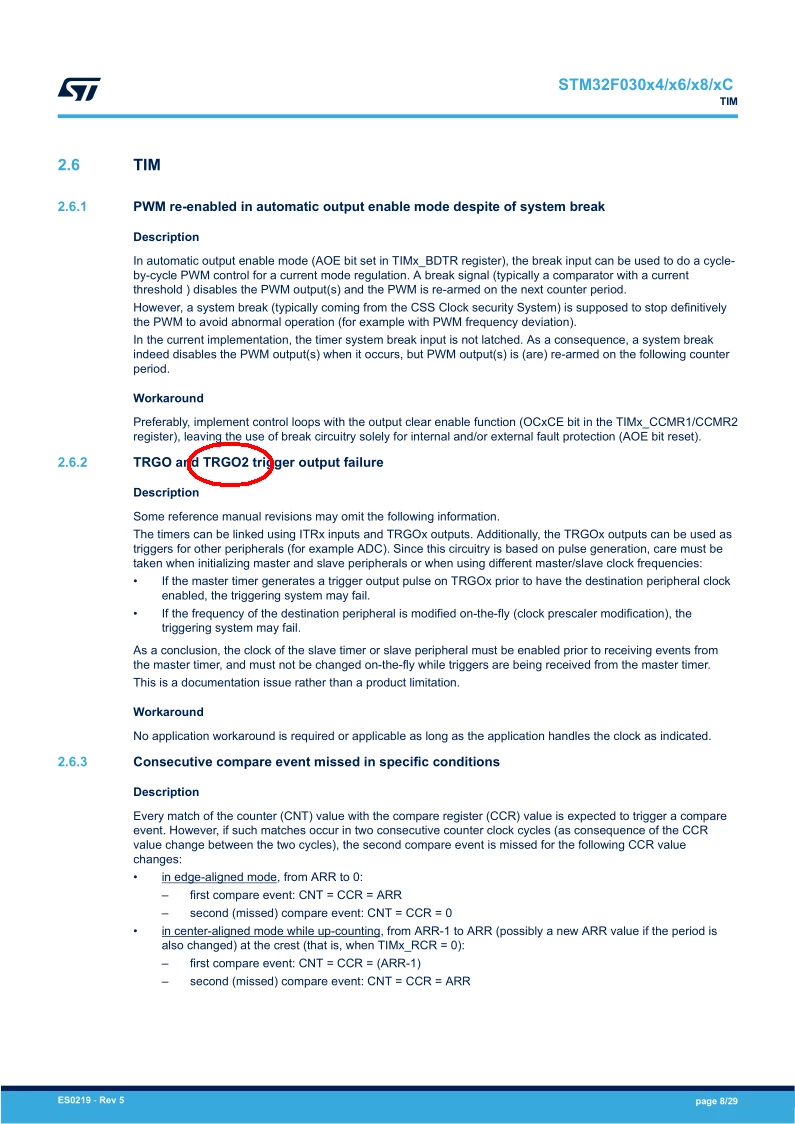

0693W000008xKwKQAU.pngThere's no TRGO2 in STM32F030.

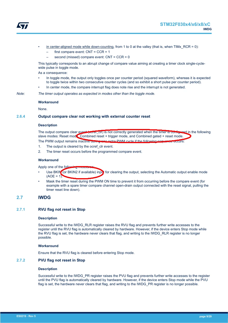

0693W000008xKwZQAU.pngThere are no Combined slave modes in STM32F030 timers, nor there is any BKIN2.

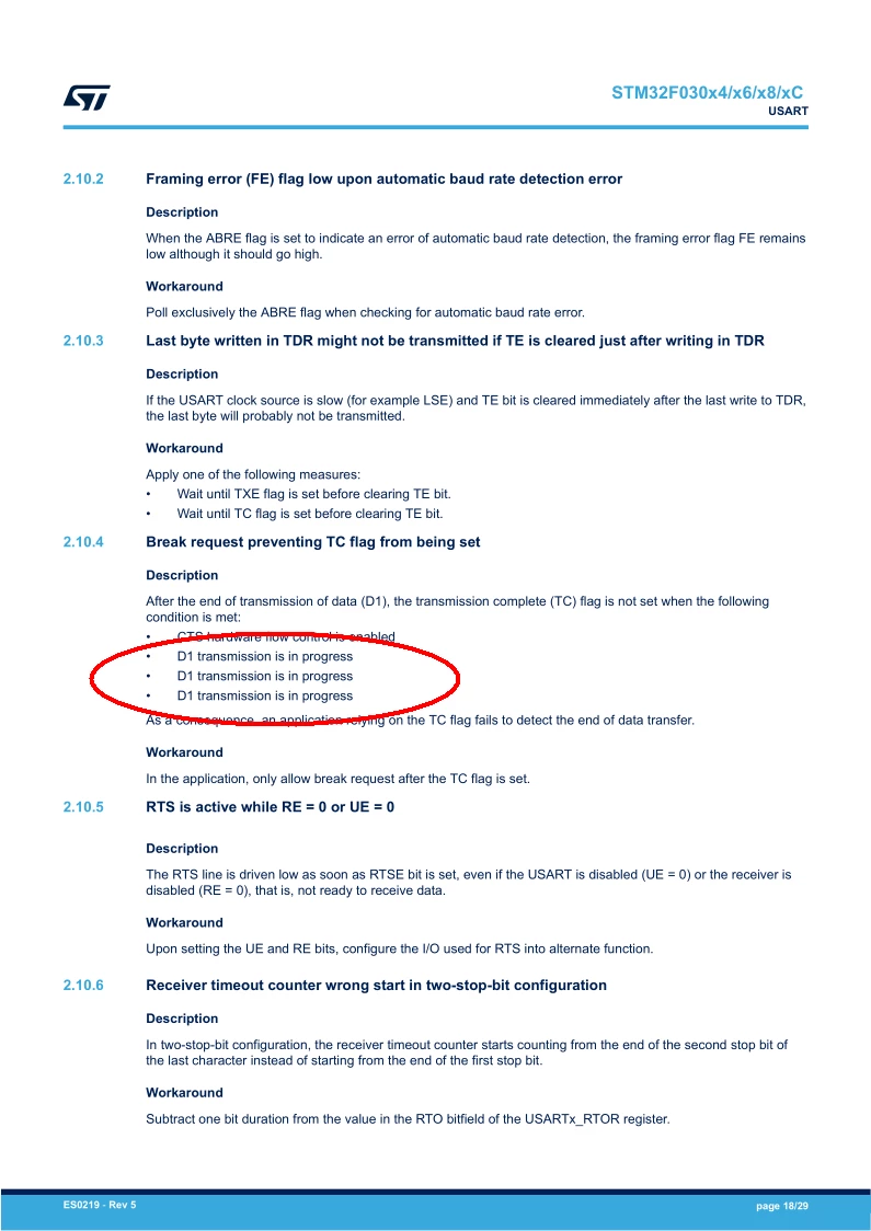

0693W000008xKvhQAE.pngWhat?
