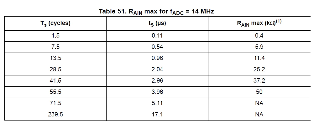

On page 67, Table 50 I see Rain listed as "External input impedance" and a max value of 50K.

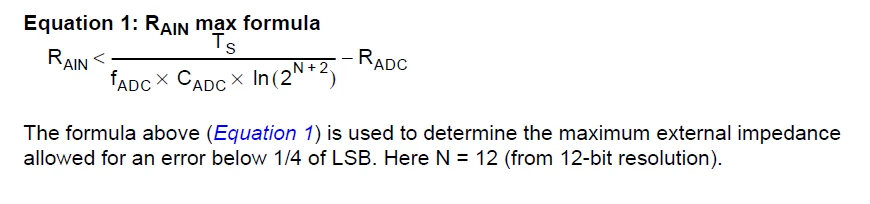

Applying equation 1, on page 68, to a 10 bit resolution with the maximum Ts of 239.5 cycles gives me a maximum external input resistance of 256K. This, of course, is more than my 100K, so it would seem I'm OK.
Table 51 on page 69 has "NA" listed for Ts of 71.5 and 239.5. There's no explanation as to why other than, as I see it, table 50 stating that the maximum external resistance is 50K.

> I don't think that reducing resolution is helping you with input impedance.
Unless I am reading it wrong page 68 of the data sheet, equation 1, seems to indicate this is a factor:
0693W00000AMHVZQA5.pngOn this next page, Table 51, they provide results for the 12 bit case:

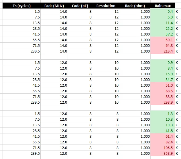

I reproduced this table and calculated the values for 10 and 8 bits and lowered the ADC clock to 12 MHz (the /4 I can use). According to this, yes, sampling rate and ADC width do give you the ability to use a larger Rin. However, the overriding fact seems to be that we are limited to 50K due mostly to leakage.
At this point I am thinking of a version of Uwe's external capacitor suggestion. I can't load the input too much because I am effectively measuring in the middle of the voltage divider for an op amp's feedback loop. I was trying to get clever and save a few components on this multi-channel design. It's looking like I won't be able to do this. My inputs can easily survive a quick low impedance sample. I could setup a FET-gated sample-and-hold using a larger capacitor to then drive the ADC input from a low impedance source. At some point the cost, complexity and errors introduced by such a solution is likely to just drive adding another set of op amps in unity gain and get on with it.
