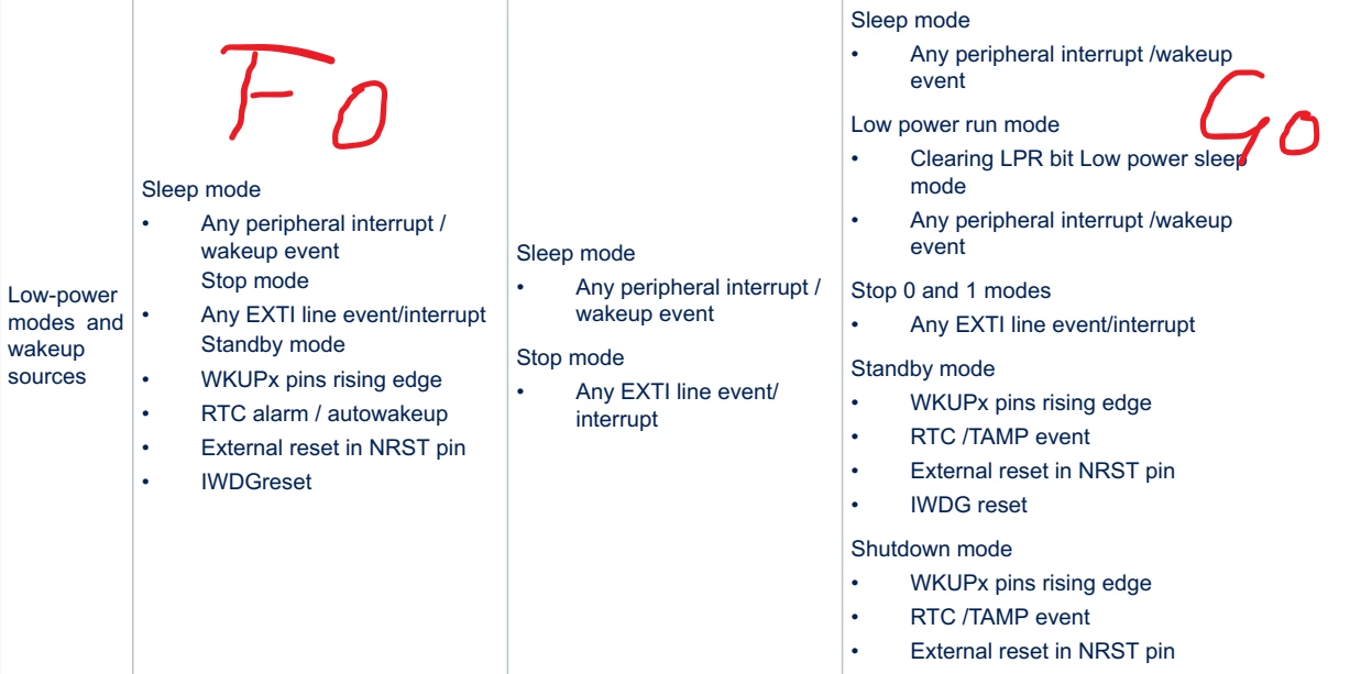

STTwo-32
Feb 29, 2024 7:17 AM UTC
Hello @huzb11 and welcome to the ST Community :smiling_face_with_smiling_eyes:.
I suggest you take a look at the AN5145 to understand how to do migration from the STM32F0 family to the STM32G0.
Best Regards.
STTow-32
huzb11Author
Feb 29, 2024 8:33 AM UTC
hi  STTwo-32:
                      I have reviewed the AN5145 document several times, but there are differences in the interrupt part between the F0 and G0 chips, as shown in the screenshot:
But I have modified the program many times for STM32G0, and since there are no routines in this area, it never runs. I have referred to the RM0444 document for the above code. Due to some registers in STM32G0 not being present on stm32f0, I am not sure where the problem lies? Can you help me take a look?
