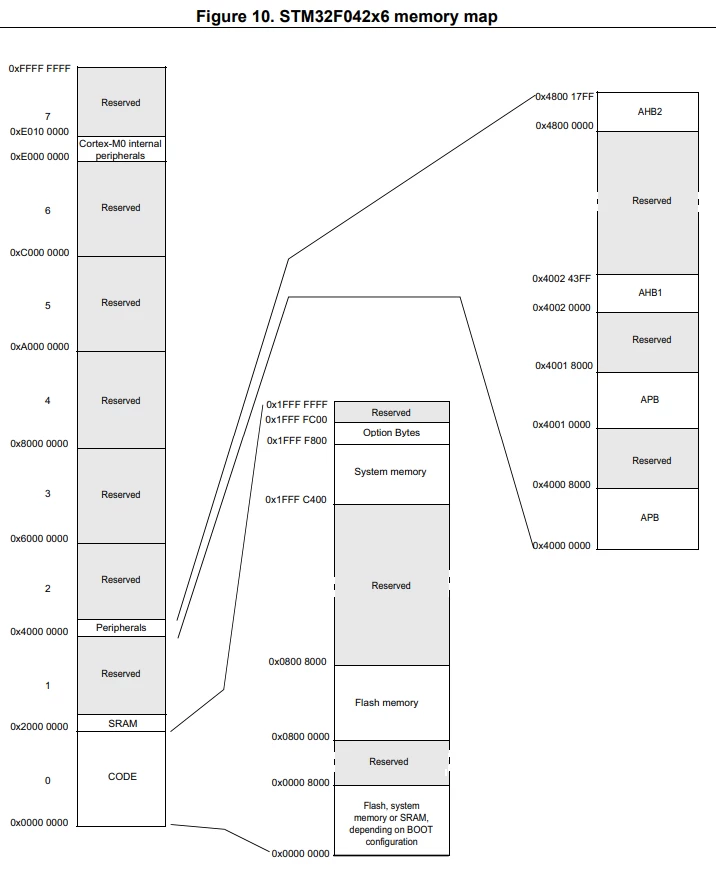

Here is the stm32f042k6 memory model (from datasheet) :
Is there a specific area for user data in flash ?

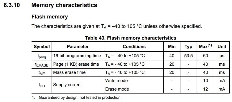

There is no special area, the only restriction is that the application vector table must be placed at 0x08000000, i.e. the lowest address in the flash, so you can't use page 0 for user data. The most straightforward way is to reserve the last pages of the flash for user data.
The flash is documented in chapter 3 of the reference manual, find the Flash memory organization table for your MCU there. Note the page size, pages are the units for erase operation, i.e. a whole page must be erased at one whenever you would like to overwrite data.
Find the linker script of your project (*.ld when using the gnu toolchain), and decrease the flash length parameter there. I have a STM32F030F4, the flash memory definition in my STM32F030F4PX_FLASH.ld reads
FLASH (rx) : ORIGIN = 0x8000000, LENGTH = 16K
the above mentioned table says I have 1K pages, so I could e.g. replace it with
FLASH (rx) : ORIGIN = 0x8000000, LENGTH = 13K
to reserve 3 pages. If you have an MCU with 2K pages, stick to even numbers.
Now the remaining area beyond the LENGTH value will never be touched by the linker, and your application is free to use it.

  • Note that the flash is not guaranteed to work after 1000 10000 erase operations.

Not 1000, but 10000 erase-write cycles.
berendi
Principal
Apr 1, 2020 6:09 PM UTC
Oops, looked at the wrong datasheet.

The flash memory which you can program (erase and rewrite) is the white block from 0x08000000 up to the grey block above it.

  • I found the flash memory definition STM32F042K6TX_FLASH.ld (generated by STM32CubeIDE), and I changed the LENGTH
  • Then I use the last page of the flash (from address 0x8007C00 to 0x8007FFF)
  • STM32F042K6 : total flash size : 32768 bytes, 32 pages (1024 bytes each)
