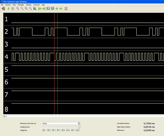

Hello.
I have a problem to cinfigure I2C.

No matter what i write after this part:
I2C1->CR2 |= I2C_CR2_START;
I2C sending data like this:
Can somebody tell me what im doing wrong, and why data from buffer TXDR are not sent?
#problem #stm32f0-i2c

Hi
I think
    I2C1->CR2|=(adress<<0)|(lenght<<16)|I2C_CR2_ADD10;    //addres SLAVE 10bits
    I2C1->CR2 &=~ I2C_CR2_RD_WRN;                        //write
Tells the I2C controller to send the start bit and the device address.
BUT then you immediately do
   I2C1->TXDR=0xff;
Then try to wait for the data to be transmitted.
      while(I2C1->ISR&I2C_ISR_TXIS);
You need to wait for the start bit and the device address to complete before trying to send the data. You need to add another ''while(I2C1->ISR&I2C_ISR_TXIS);'' or something before the ''I2C1->TXDR=0xff;''

Thank you for response.
The problem was here:
 I2C1->CR2|=(adress<<0)|(lenght<<16)|I2C_CR2_ADD10;    //address SLAVE 10bits
I was try to send 8 bits address, but that was send only 2 MSBs on 10bits mode, and slave dont send ACK, so master try to send again that 2 bits. This is working ''write'' code:
