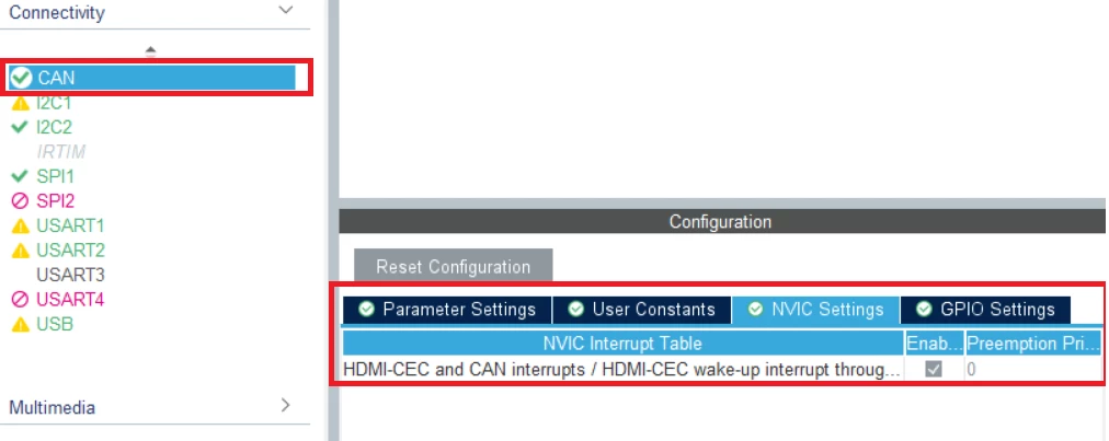

turned out the stby pin on the can transceiver needed to be explicitly grounded. Now I am able to Tx on the stm32f0. Unfortunately Rx does not work. There is no option to turn on rx interrupt handler in nvic settings
mƎALLEm
September 21, 2021
This is the option to enable CAN interrupt in CubeMx for F0:0693W00000Dnv16QAB.png
