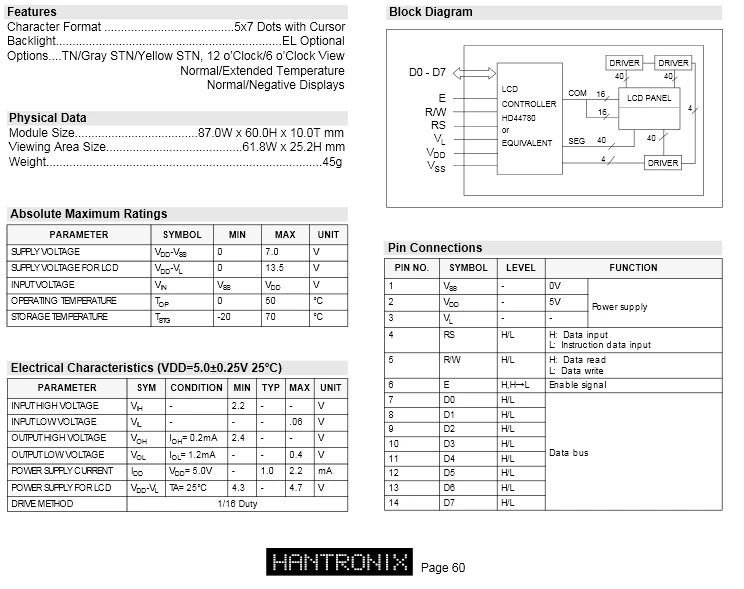

Hello everyone,
I have a problem with connecting STM32F0 Discovery board with Hantronix HDM16416H LCD display. I don't know which STM32 pins should be chosen to connecting STM and Hantronix LCD 4x20 display properly.
I have it set, as below:
LCD pin  -> STM pin:
E pin ->    PC10 pin
R/W pin -> PC11 pin
RS pin -> PC12 pin
VDD pin -> 5V pin
D0 pin  ->  PA3 pin
D1 pin ->  PA2 pin
D2 pin -> PB12
D3 pin -> PB11
D4 pin -> PA7
D5 pin -> PB9
D6 pin -> PB8
D7 pin -> PA6
Is it correct?
There is a description of LCD from the manual.
    Pretty much what ever available GPIOs you have available. I'd generally recommend wiring a 4 or 8-bit data bus using consecutive pins from a GPIO Bank so the software implementation doesn't become a train wreck. Does it really need 8-bits? Most of these displays can use 4-bits, and it makes no difference to the inherent slowness of them.
    Go look at some other 16x2 display implementation on other STM32 processors, and how the software abstracts the pin utilization.
