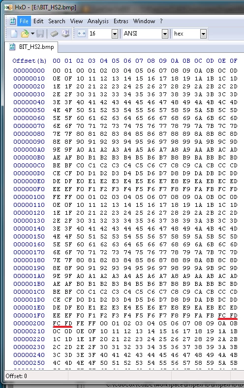

I am getting a strange file write error when using HS USB lib and FATfs. this error does not occur in FS mode.
When I write 2 bytes to a file and then 1024 bytes, some (2)  of the 1024 bytes are repeated at 0x200. See picture below.
If I don't write the 2 bytes first then all appears to be OK.
I am working on a STM32F407 and have a USB3200 PHY. ( However the same problem also occurs on the STM3220G-EVAL. board )

    Tesla DeLorean
    Guru
    February 10, 2014
    Posted on February 10, 2014 at 18:02
    Got some odd stuff going on a the front of the buffer too, and it's all shifted!
    Ponder if it's related to memory alignment, or some thing else going on in the abstraction layer below. Really not enough to work with here.

    louis
    louisAuthor
    February 11, 2014
    Posted on February 11, 2014 at 10:05
    Thanks for your reply Clive...
    The start of the buffer is correct... If you can see in the code I write 2 bytes and then write 1024 bytes so it should be 0x00 0x01 and then 0x00 -> 0xFF repeats.

    When I run the USB in High Speed Mode it repeats the 2 bytes at 0x200 but when I run it in Full Speed mode it works as expected - no bytes repeated.
    I have tested it in IAR, KEIL and CooCox and also on the STM32F407 CPU.
    I noticed it when writing a HD Bitmap file 1920 x 1080. It was happening almost every line. The problem was much reduced ( approx. 8 errors in the file ) when I commented out
    #define USB_OTG_HS_INTERNAL_DMA_ENABLED
    But I am not an expert in the USB lib so that was just hacking :)
    I would love to know is anybody out there had a High Speed setup and can write 2 bytes and then 1024 bytes and not see this error.
