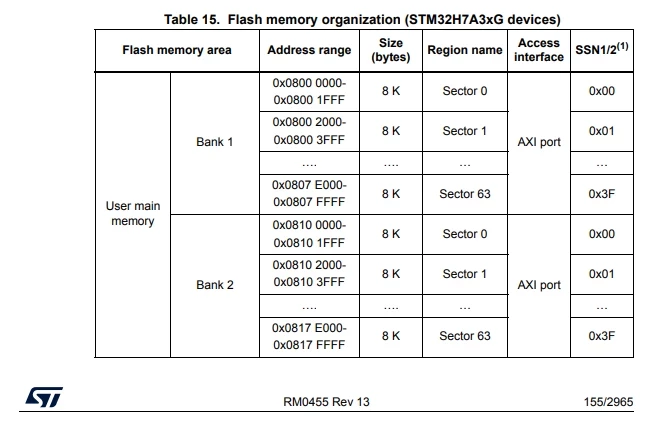

We are working with STM32H7A3 boards and are currently migrating our build and flashing toolchain from STM32CubeIDE 1.9.0 to 2.2.0. During the migration we ran into a flash programming failure that we have traced to the device description, and we would like your confirmation before we adopt a workaround.
WHAT WE OBSERVE
Programming at 0x08100000 is rejected with "Operation exceeds memory limits" under 2.2.0. The same operation succeeded under 1.9.0.
Investigating this led to two findings on Device ID 0x480:
  1. STM32_Prog_DB_0x480.xml declares the Bank 2 base address for the 1 MB configuration as 0x08080000, which contradicts RM0455 Rev 13, Table 15, and consequently excludes the documented Bank 2 base at 0x08100000 from the valid range;
  2. Writes to 0x08080000 are accepted and verify successfully on our samples, despite Table 15 listing that range as not mapped.

RM0455 Rev 13, Table 15 (Flash memory organization, STM32H7A3xG devices) specifies:
  Bank 1:                  0x08000000 - 0x0807FFFF, sectors 0-63
  Bank 2:                  0x08100000 - 0x0817FFFF, sectors 0-63
  0x08080000 - 0x080FFFFF: not mapped

  1. Please confirm whether RM0455 Table 15 or the device description file is authoritative for STM32H7A3xG, and correct whichever is in error.
  2. Please clarify how the 0x08080000 - 0x080FFFFF range decodes on STM32H7A3xG. In particular, is this range an alias or alternate address window for Bank 2, or does it correspond to a distinct physical Flash region? We need to know which bank the range belongs to, since that determines whether read-while-write applies between an image slot placed there and code executing from Bank 1.
If the range is not mapped and not supported, we accept that and will keep our layout at 0x08100000. In that case, however, the device description supplied with CubeProgrammer is directing users to program at an address that ST does not support, while writes to that address are accepted and verified rather than rejected. We would therefore ask you to treat this as the primary issue.
Our concern is that the tooling reports success throughout the entire programming and verification flow. A user following the address mapping presented by CubeProgrammer 2.2.0 could therefore program, verify, and ship a device with its secondary image slot located in a range that ST does not support, without any warning that the address is outside the documented Flash map.

Closing this from our side. Summary for anyone finding this thread later:
On the STM32H7A3xG, Bank 2 starts at 0x08100000. The two banks are not contiguous, see RM0455 Table 15. ST has confirmed this and is filing a documentation change.
Note that STM32CubeProgrammer 2.2.0 still rejects programming at 0x08100000 with "Operation exceeds memory limits", and still accepts and verifies writes at the unmapped 0x08080000, because the address map comes from the device database file STM32_Prog_DB_0x480.xml. Until a corrected database ships, patching that file locally is the workaround.
