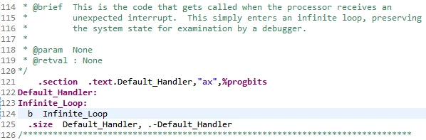

Hi there, I am using the STM32CubeMx code generator with the STM32L053 discovery board. In CubeMx, I enabled USART2 and changed the baud rate to 9600. Also, I configured the pins PA0 for user push button, PA5 for red LED, PB4 for green LED.
Here is a snippet of code that i inserted in TrueStudio:
/* USER CODE BEGIN 2 */
HAL_GPIO_WritePin(GPIOA, GPIO_PIN_5, GPIO_PIN_RESET);
HAL_GPIO_WritePin(GPIOB, GPIO_PIN_4, GPIO_PIN_RESET);
HAL_GPIO_WritePin(GPIOB, GPIO_PIN_4, GPIO_PIN_SET);
/* USER CODE END 2 */
This is before the code generated for FreeRTOS but the debug never reaches this line of code. It gets stuck here line 124: 0690X00000605XWQAY.png However, if i were to disable the USART2 in CubeMx, the LED works! Is there some configuration procedure to note??? I have not called the function HAL_UART_MspInit yet...

    I did a step over debug starting from the main() and found out that the function MX_GPIO_Init(); generated by STMCubeMx went into the infinite loop.

    During debugging, i stepped through and found that the line MX_GPIO_Init(); caused the debugger to go to the Infinite Loop in the file startup_stm21l053xx.s.
    Anyone know what is going on??? I am just trying to enable LEDs and USART only...

    Are you sure it's not Hard Faulting? What other vectors in the table are pointing at this Default Handler location?
    Review the vector table, review the .MAP, and understand the registers and stack state immediately prior to it trapping into the loop.

    There is a known issue that will be fixed in STM32CubeMX 4.4.
    Please update the generated code as highlighted below to ensure the systick handler code is called only only once freeRTOS is initialized:
    void SysTick_Handler(void)
    if (xTaskGetSchedulerState() != taskSCHEDULER_NOT_STARTED) {
        xPortSysTickHandler();
    HAL_IncTick();
    Best regards
