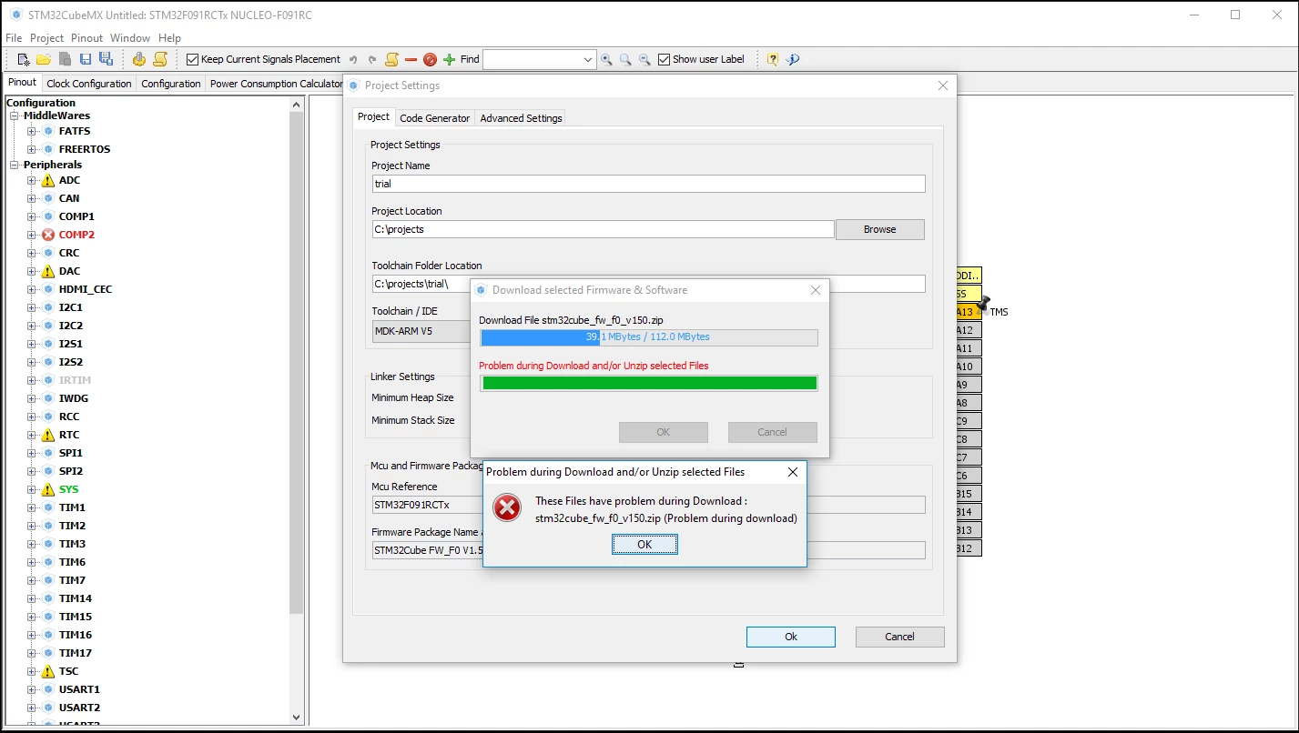

I'm using the STM32CubeMX Version 4.14.0 STM32CubeV1.0
trying to generate a project for the NUCLEO-STM32F091RCT6 board.
Please take a look at the attached snapshot: Looks like that when it downloads
the needed software package something goes wrong. It systematically stops
the download at 39.1MBytes of 112.0 MBytes.I've tried many times with the
same result. I don't have any firewall activated.
my Windows 10 version is the 64bit one, Version 1511.build 10586.164
any hint?
thanks

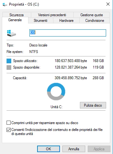

    May be your disk has reached saturation and you don't have space enough.
    -ForumSTM32-
    enricopassoni1
    April 1, 2016
    Posted on April 01, 2016 at 08:19
    with 120gb of free space?
    anyway it's a really strange thing, partially solved loading the .zip locally
    stm32cube-t
    April 15, 2016
    Posted on April 15, 2016 at 10:19
    Dear user,
    We suspect a corrupted download that has been cached at the proxy level. Please try again and let us know and if you're still facing the issue, please send us
    STM32CubeMX.log
    file (in your usr/.stm32cubemx directory).
