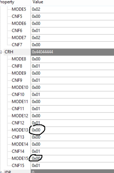

But unfortunately the LED is not blinking.
Entered Keil debuger, GPIOC and noticed that MODE13=0, so entered manually value 1 (MODE13=1) and the LED started blinking.
It seems that the LL GPIO driver is somewhat broken because the MODE is wrongly set.

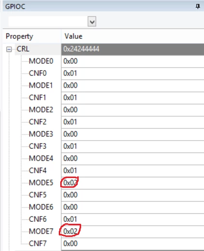

    Jan 24, 2018 6:27 AM UTC
    Posted on January 24, 2018 at 07:27
    DAHMEN.IMEN
    How to reproduce:
    If you want to make PC13 and PC15 outputs:
    GPIO_InitStruct.Pin = LED_Pin|LL_GPIO_PIN_15;
    GPIO_InitStruct.Mode =
    LL_GPIO_MODE_OUTPUT;
    GPIO_InitStruct.Speed = LL_GPIO_SPEED_FREQ_LOW;
    GPIO_InitStruct.OutputType = LL_GPIO_OUTPUT_PUSHPULL;
    LL_GPIO_Init(GPIOC, &GPIO_InitStruct);
    You can see that CRL is configured by the LL:
    instead of CRH:
    so when you try to fix it you use:
    GPIOC->CRH = 0x24244444;
    Can you consider it a bug?
