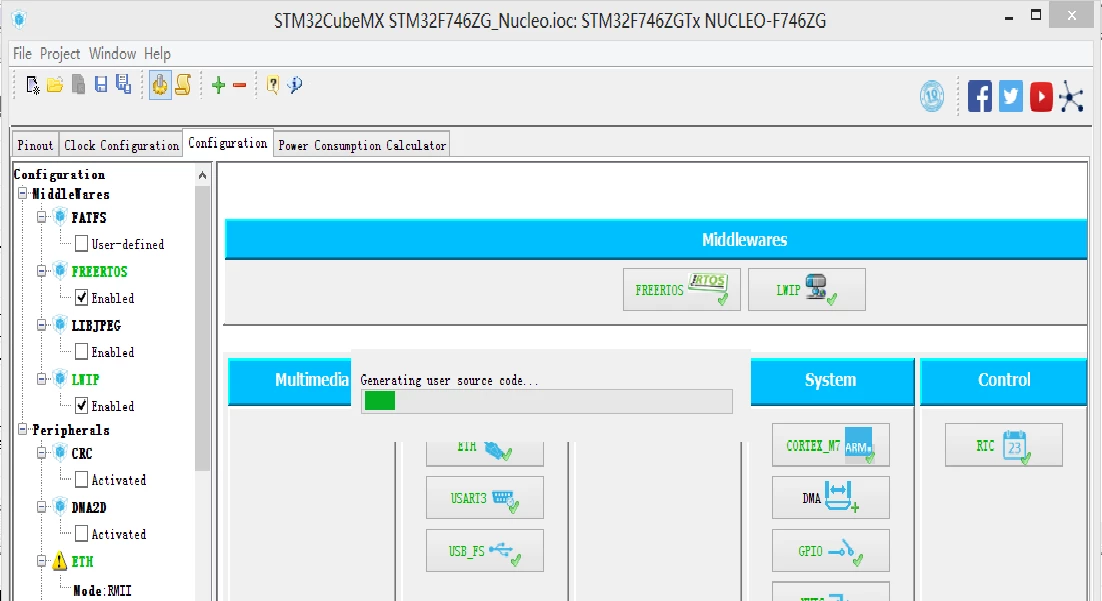

STM32Cubemx stuck in ''Generating user source code''
Posted on April 08, 2017 at 08:29
I recently installed cubemx 4.20 latest version 4.20.1
I can generate the project only 1 time, later if i try to update the project by adding new peripherals, i can not able to generate the code, the whole application is stuck in 'Generating user source code '. the only way i can close this application is killing it by 'Task manager'. it happens every time. Please help

    Hello
    n.serina
    In fact, the problem you highlighted is solved in CubeMX4.1.
    Please, upgrade with the latest release of CubeMX.
    Here is a screen shot of the CubeMX4.1 release note :
    Hope it will help you and that you won't encounter this issue in the future.
    BR. Eric

    Thank you so much for the help, i came to know that after updating my KEIL-MDK-5 software, the issue got resolved automatically,

    I experienced this as well, and determined this was due to other processed accessing the generated files immediately.
    Think about Dropbox, Owncloud or other indexing and cloud software.
    Moving out of these managed folders resolved the problem.
    Pausing these services while inside the managed folder resolved the problem.
