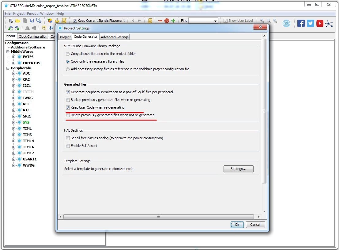

Steps to reproduce.
Create new STM32CubeMx project and generate sources as usual:
- Open STM32CubeMx -> New project -> Select MCU (STM32F030K6 in my case)
- Project -> Settings -> _some_project_name_entered_
  Note:  EWARM toolchain stays as it was by default
- Project -> Generate code
- Close STM32CubeMx
- Open STM32CubeMx project from last saved folder
- Make some changes in pinout

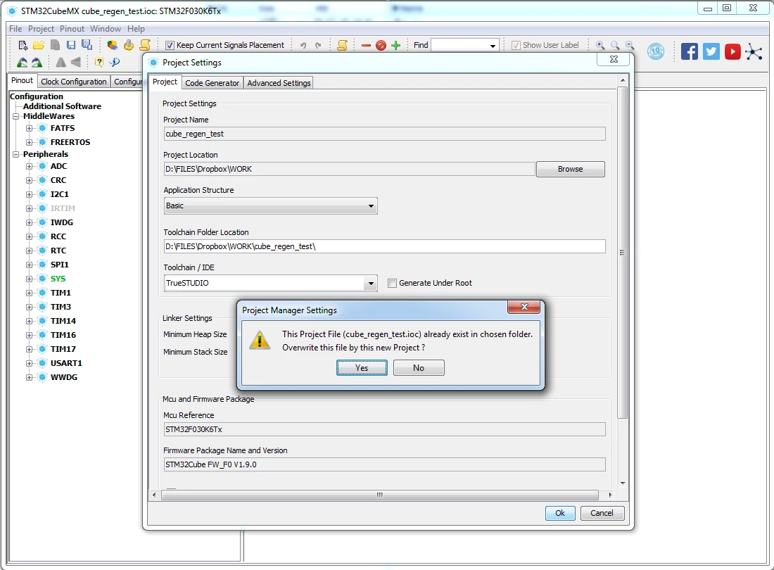

To this moment all works fine, but when I want to change toolchain to
TrueSTUDIO and generate project to same folder all files in folder are deleted
and I losts all my changes in main.c and other files:
- Project -> Settings -> Toolchain: TrueSTUDIO (Generate under root unchecked)
- Ok button press and I get message ''This Project File (cube_regen_test.ioc)
  already exist in chosen folder. Overwrite this file by this new Project?''.
- Ok button pressed on Overwrite confirm messagebox
Expected behaviour on regeneration:
- All user file stays untouched
- Cube generated files changed accordinly to new configuration and users code
sections keeps

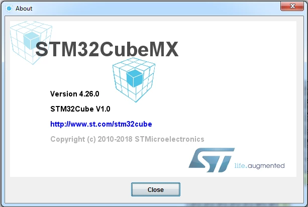

STM32CubeMx Version 4.26.00690X0000060CARQA2.png0690X0000060CBUQA2.png0690X0000060CBPQA2.png

    Hello
    Thanks for your feedback.
    Issue will be resolved in next STM32CubeMX release (4.27.0).
