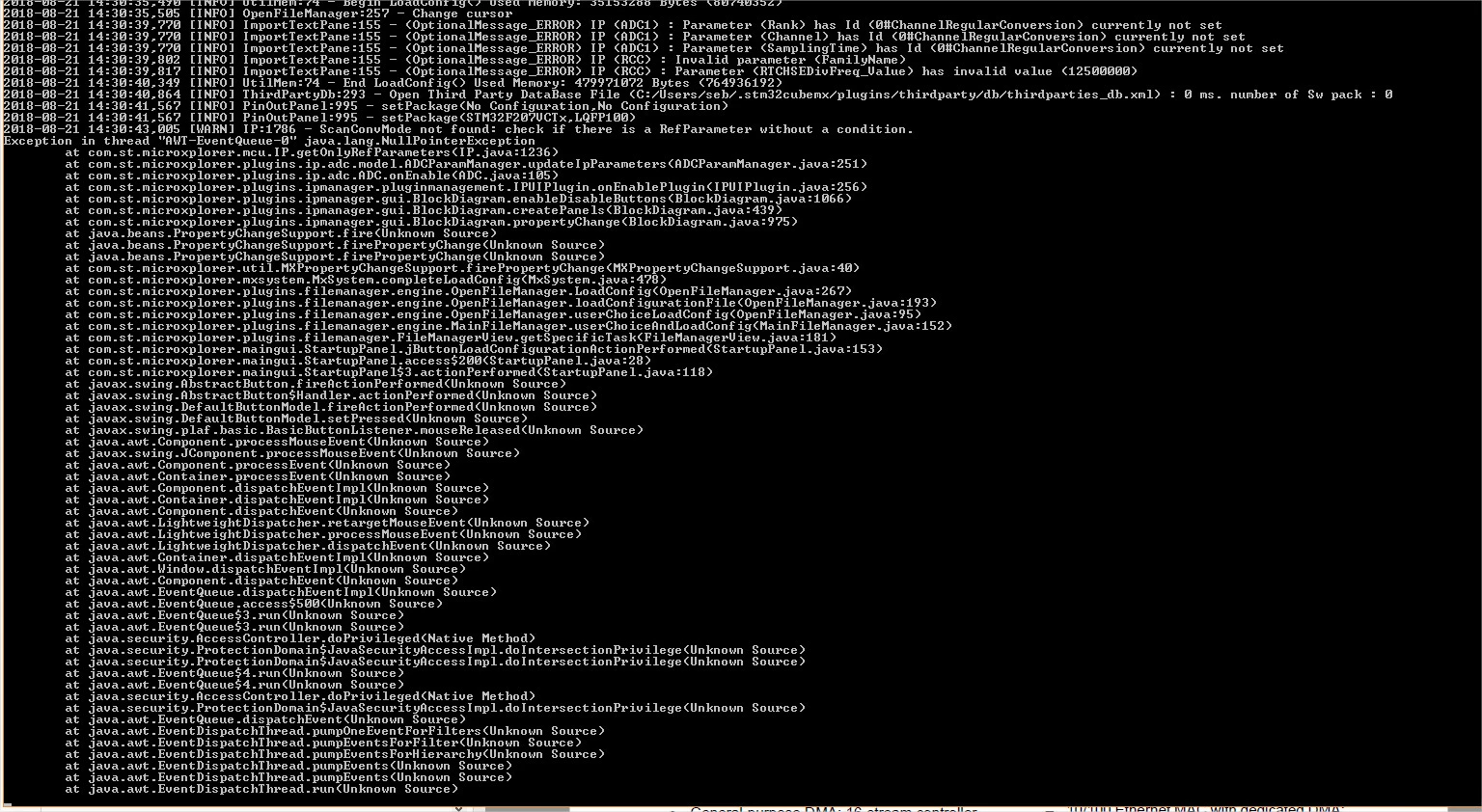

    Yes, effectively !!
    But how I can resolve the problem ?
    I have a NullPointerException in "com.st.microxplorer.mcu.IP.getOnlyRefParameters(IP.java:1236)"
    Thanks !

    I found the bug !!!
    Here the steps to produce it :
    1. Start the STM32CubeMx software with the following command (to able to show the output debug)
    java -jar "c:\Program Files\STMicroelectronics\STM32Cube\STM32CubeMX\STM32CubeMX.exe"
    1.
    2. Click on "New Project".
    3. Write in "Part Number Search" : STM32F207VC
    4. Double click on the only part available.
    5. As soon as you are in "PinOut" tabulation, uncollapse "ADC1".
    6. Activate "IN0".
    The bug appear.
