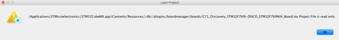

STM32CubeMX permissions bug. Seems benign, but you be the judge.
  • August 9, 2017
  • 990 views
Posted on August 09, 2017 at 02:13
Mac install, CubeMX 4.22.0, but all the versions do this.  The Mac installer is broken and has been for many versions, so we install from the command line with sudo java -jar.  At any rate, when making a new project, this error message comes up, and it shows a bad path.  See attached image. specifically where it says db//plugins.  that extra slash is probably what borks it.

    Hi
    doe.john.016
    This is internally reported to our CubeMX team. We will keep you posted about any further update.

    Hello
    doe.john.016
    Great thanks for your comment.
    Could you describe a bit more your environment ?
    Which java version, which OSx version ?
    I think the point is that you have installed the application with root right.
    Could you check the file privileges ?
    It should be 644, owner must be your user and its group should be admin (if your user is part of the admin group).
    Could you try to reinstall with normal user rights (you can do it by specifying another directory)?
