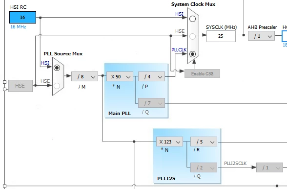

I've used the STM32CubeMX application to setup the main PLL and PLLI2S as shown below:
When I generate the code, it generates the following:
PeriphClkInitStruct.PeriphClockSelection = RCC_PERIPHCLK_I2S;
PeriphClkInitStruct.PLLI2S.PLLI2SN = 123;
PeriphClkInitStruct.PLLI2S.PLLI2SM = 8;   // <--- Compilation failure, PLLI2SM is not structure element
PeriphClkInitStruct.PLLI2S.PLLI2SR = 5;
PeriphClkInitStruct.I2SClockSelection = I2S_CLOCK_PLL;
// <-- I2SClockSelection is not a struct element
if (HAL_RCCEx_PeriphCLKConfig(&PeriphClkInitStruct) != HAL_OK)
_Error_Handler(__FILE__, __LINE__);
As shown in the comments in the code above, both PLLI2SM and I2SClockSelection are not members of their respective structures.  This results in a compilation failure...  Anyone know what's going on here?

Sep 28, 2017 8:41 AM UTC
Posted on September 28, 2017 at 10:41
Please share your ioc file and precise which CubeMx version are you using ?
Best Regards
Imen

Sep 28, 2017 5:45 PM UTC
Posted on September 28, 2017 at 17:45
Hi
tmdarwen
Thanks for sharing this issue.
I checked and confirm the error for
PLLI2SM and I2SClockSelection.
I raised thisissue internally to CubeMx team tofix it.
Thanks and Best Regards
Imen

Jeanne Joly
Jeanne JolyBest answer
Feb 6, 2018 2:18 PM UTC
Posted on February 06, 2018 at 15:18
Hello
tmdarwen
Just to be precise, this issue was solved in CubeMX4.
You can upgrade your CubeMX with the latest (cubeMX4.24).
BR. Jeanne
