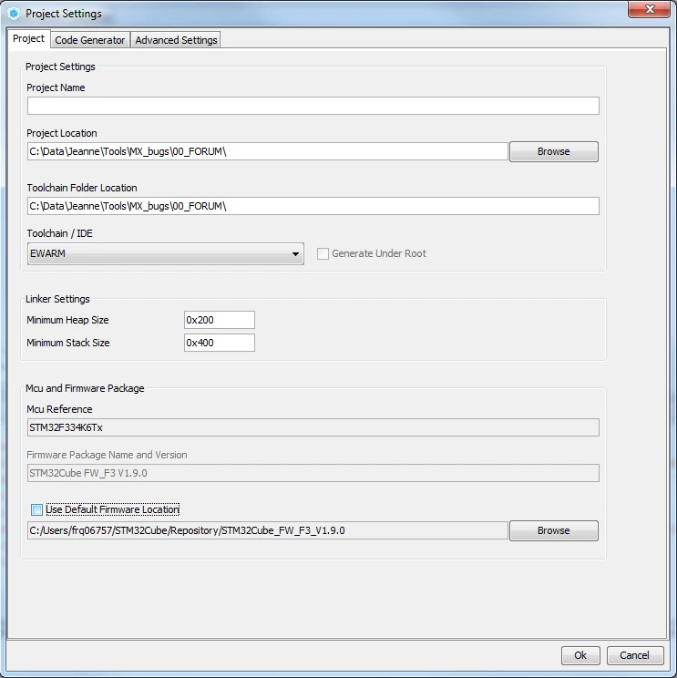

we want to set path for 'Mcu and Firmware Package' to path relative to CubeMX project directory. Rationale - in case you store CubeMX and other source files into VCS, the absolute path to the Firmware package may be different on each computer. The relative path is always same.
We also want to set 'Toolchain Folder Location' - now this field is not editable.
Thanks a lot.

    Hello
    jan.humpl
    In the latest CubeMX release (CubeMX4.24), open File/Project Settings, the toolchain folder can be changed and for the Firmware location, you can untick the button ''Use Default Firmware Location'' and set the path you want :
    I hope it will help you.
    BR. Jeanne

    Posted on January 30, 2018 at 10:23
    The behavior is identical to previous version. I cannot set path relative to the current directory (e.g. '..\..\..\..\3party\STM32Cube_FW_H7'). If I try to set relative path I will get this error:
    But the message is not true - I am sure that the folder contains mentioned directories.

    Posted on January 30, 2018 at 11:02
    Please, have a look to
    http://www.st.com/content/ccc/resource/technical/document/user_manual/10/c5/1a/43/3a/70/43/7d/DM00104712.pdf/files/DM00104712.pdf/jcr:content/translations/en.DM00104712.pdf
     doc, paragraph 5.8.1 Project tab, you will have an explanation on how to reuse the same Drivers folder across all projects that use the same firmware location.
    It should help you.
