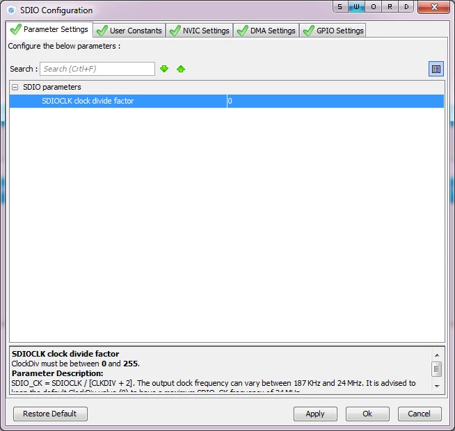

    Probably I put this clock too fast ? 0 = 24 MHz ??

    Can it be because my Init SDIO clock too fast ? Why can't I read this message properly ? Always got unexpected error ? server problem here ?
    antonius
    antoniusAuthor
    March 1, 2017
    Posted on March 01, 2017 at 11:46
    I reduce the SDIO clock, and it can write properly already, thanks a lot guys

    I changed this configuration in this file : stm32f1xx_II_sdmmc.h
    And now it's working properly
    /* SDIO Intialization Frequency (400KHz max) */
    #define SDIO_INIT_CLK_DIV ((uint8_t)0xC3)
    /* SDIO Data Transfer Frequency */
    #define SDIO_TRANSFER_CLK_DIV ((uint8_t)0x3)

    Hey guys, I think the issue is that Cube is generating sdio.c init code that has the hardware flow control option set to off. This is different than the examples provided in the cube driver and example distro, which has flow control enabled:
    hsd.Init.HardwareFlowControl = SDIO_HARDWARE_FLOW_CONTROL_ENABLE;
    Lowering the clock speed does appear to work also, because flow control is not needed when you get low enough.
