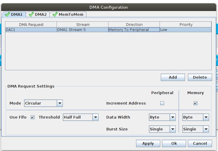

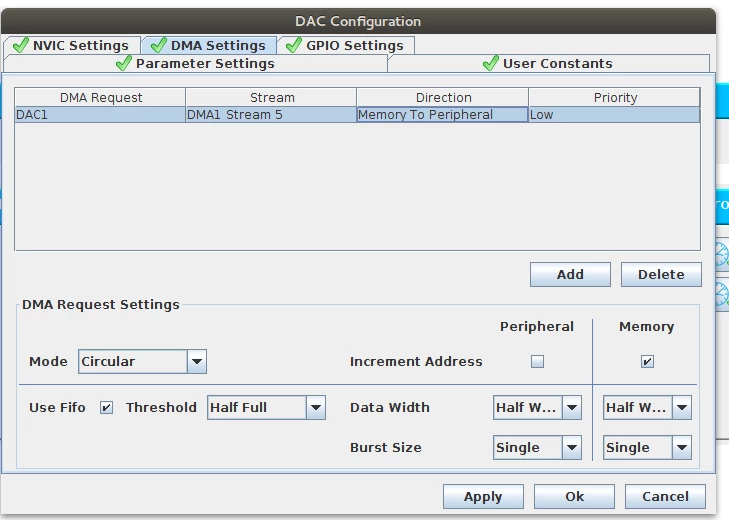

1. Open DAC Configuration and set Data Width to ''Half Width'' .
2. Generate code. Generated stm32f7xx_hal_msp.c has following lines despite the ''Half Width'' setting.
    hdma_dac1.Init.PeriphDataAlignment = DMA_PDATAALIGN_BYTE;
    hdma_dac1.Init.MemDataAlignment = DMA_MDATAALIGN_BYTE;
3. Open DAC Configuration. Data width seems to be ''Half Width'', but in DMA Configuration, it's changed to ''Byte''.
    2 replies
    Nesrine M_O
    June 28, 2016
    Posted on June 28, 2016 at 11:32
    Hi sakurai.hiroshi,
    I'll report this issue to our MX team for checking. Sorry for the inconvenience it may bring.
    -Syrine-
    stm32cube-t
    July 4, 2016
    Posted on July 04, 2016 at 18:44
    Dear user,
    Please note this issue will be fixed with STM32CubeMX 4.16.
    Best regards
