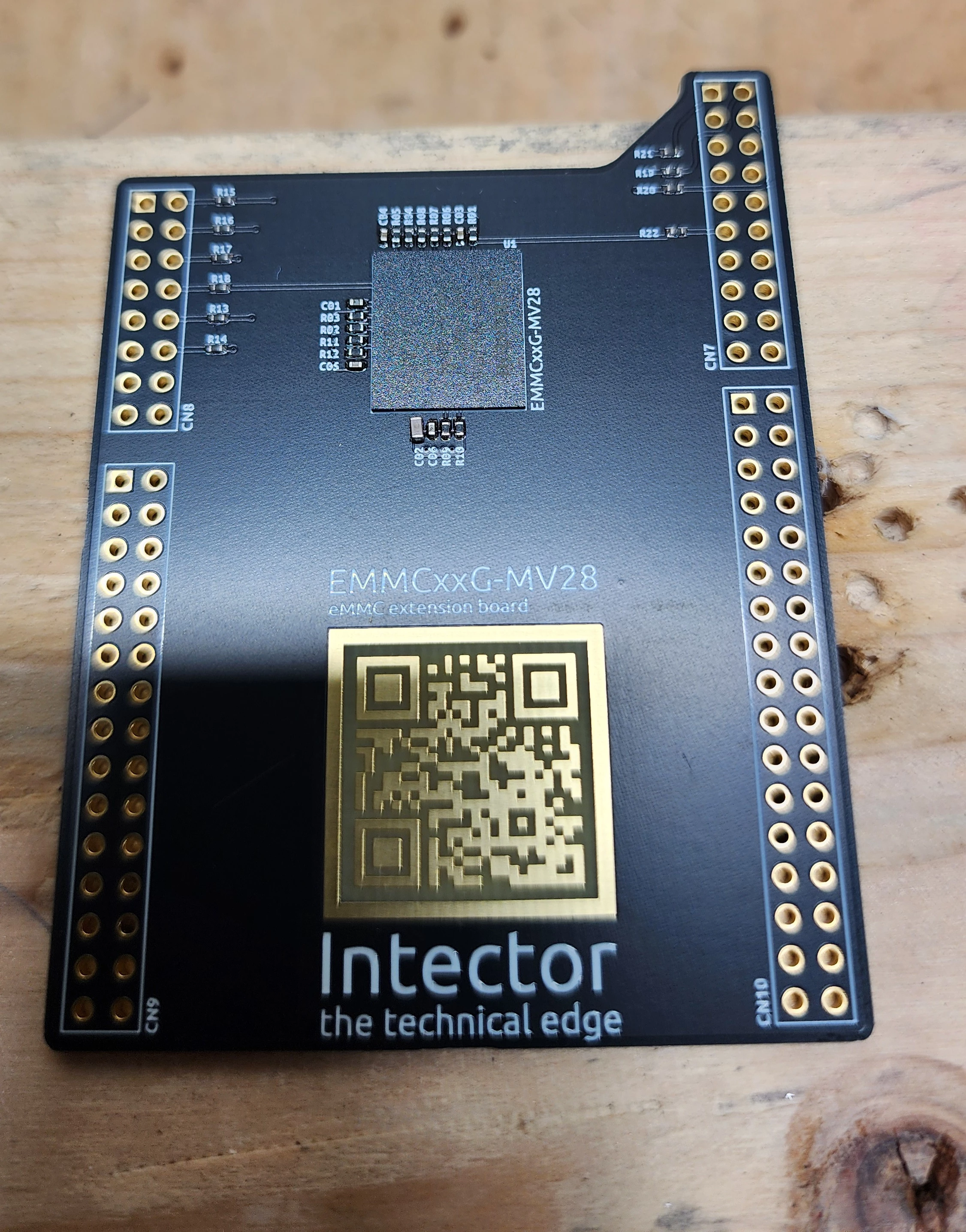

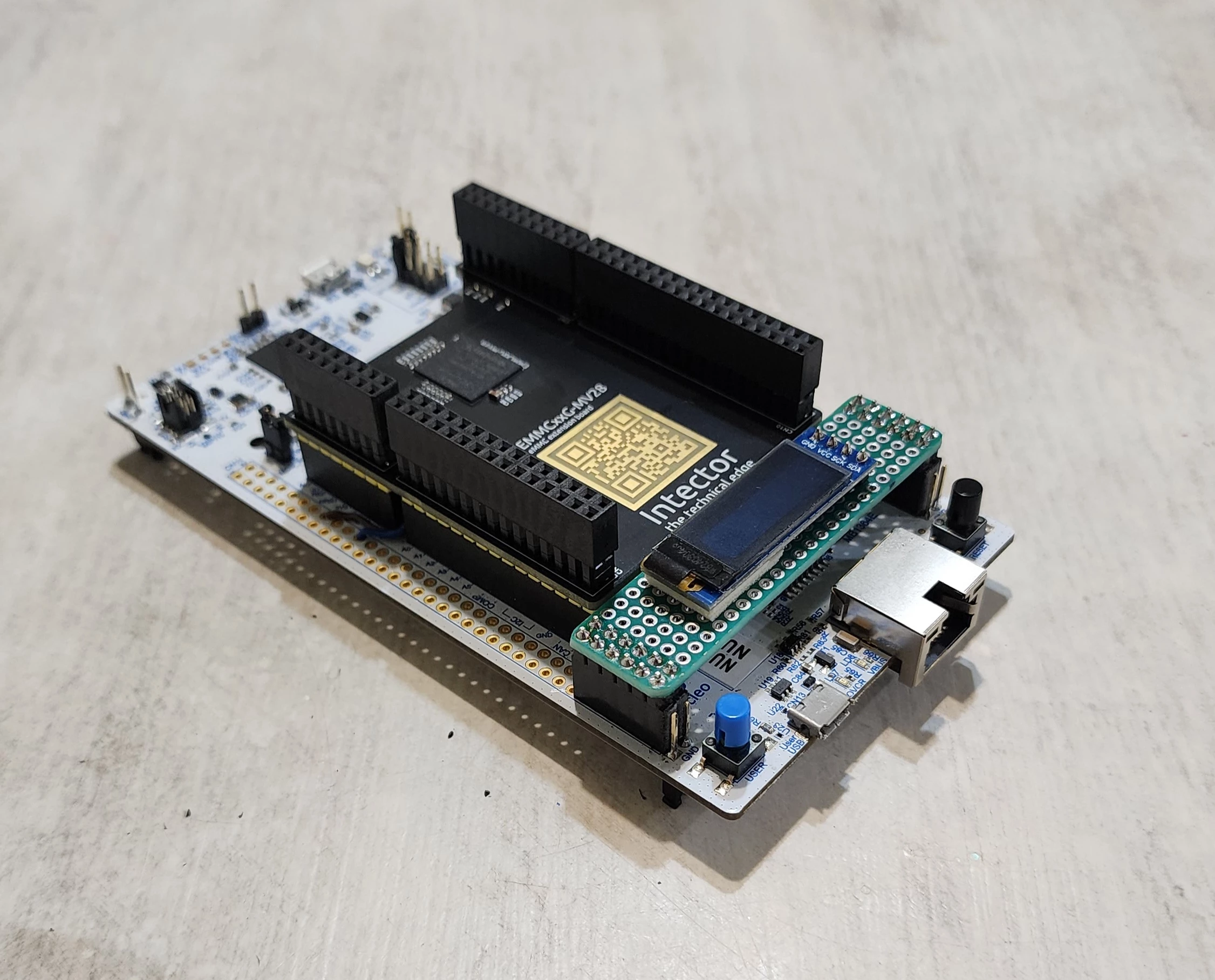

Thank you for the answer. I've been working with STM32 MCUs for quite some time now and have to say that I like them for many reasons. The STM32H7RS series caught my attention at the Embedded World in Austin, TX. I've noted those MCUs before but never showed any serious interest until I encountered a memory shortage in one of my projects. This project was initially started with the STM32H753ZI MCU and utilized quite a bit of AZRTOS. The integrated HTTP and FTP servers use an EMMC08G-MV28-01J10 for their content, which works very well. The RAM shortage becomes visible when I try to add my IO-Link driver(I've attached some pictures of my EMMC board).
This led to the decision to use an MCU capable of controlling external memory. The STM32H7RS MCU, with its XSPI interfaces, would be the perfect candidate for this project. I got two of the NUCLEO-H7S3L8 boards to test things out. Unfortunately, I could not get anything to work on those boards. I tried unsuccessfully several STM32CubeIDE examples, as described in their documentation. I'm unsure how much time I spend finding detailed information on the internet regarding the STM32H7RS MCUs.
