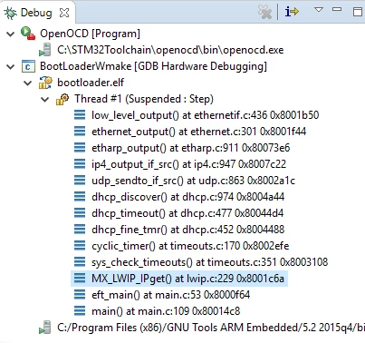

I start a project with STM32CubeMX and a NUCLEO-F207ZG board. My goal is to have a TFTP client, but for now I'm stuck getting an IP address with DHCP. You can find my project attached.
In the lwip.c, I had to modify the MX_LWIP_Init.c file of the generated code (not in the user section), otherwise the code stops in
LWIP_ERROR('netif is not up, old style port?', netif_is_up(netif), return ERR_ARG;);
What is wrong with the STM cube configuration ?
Plus, I never go to the ethernet interrupt. How the ethernet reception is handled when there is no operating system ? (NO_SYS configuration)
